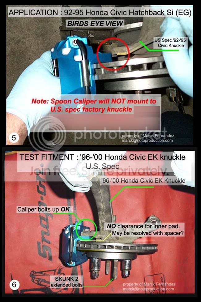

Old Sep 10, 2006 | 01:01 PM
JEM MotorSports's Avatar
Posts: 724
From: Los Angeles, CA, USA
THE FACT IS!!!
You CAN roll with a 15'' wheel with SPOON calipers as long as the offset is 35.
Most knock offs are only 40 or 38 offset.
that's why real Spoon sw388 were available in a 35 offset.
(NOTE: Work Emotion wheel is a great alternative.... if you can afford them LOL.
Spoon race team uses them quite regularly. )
anything greater than a 35 such as 32 or 30 offset will rub fender. fender will have to be rolled out or you can put washers when mounting your fender which will make your fender slightly stick out further than your door.
It is done this way in the Spoon '95 4dr civic.
Furthermore, if you drive an EK or EG (and I use those codes loosely, but you know what I mean.) You will have to swap out knuckles & bearings for '94 up integras. Reason being is that it will give you proper mounting clearance for mounting your new SPOON brakes.
OH YEAH, and you'll need extended hub bolts like drag car racers use too.
True EG SIR models from Japan don't need to swap out knuckles. (One up on us again,...lucky bastards. LOL)
Trust us, we've spent countless hours mix matching and test fitting a few years back.
But it's all worth it.
However, one itsy bit of advice. Once the install is complete. Test your brakes around the block a few times and pump the $hit out of them. If they feel spongey, it's because your firewall is fluctuating. The pressure is so great placed on the master brake cylinder (MBC) that it will actually move slightly. Test the theory with a friend. Pop the hood and have one pump the brakes while car is running and the other person can check the MBC.
That is why companies like CARBING produce a front upper strut bar with a MBC brace incorporated in to it.
SOME PEOPLE already spent a crap load of money on their existing strut bar, now I have to spend 250ish on a new one???
NO!
We have a Master Brake Cylinder Brace comming out shortly....
(good lucky kiddies, the Cusco one only works on right hand drive applications for EK & EG.)
hope the info helps.
email us if you have questions. jemmarck@hotmail.com
Modified by JEM MotorSports at 2:16 PM 9/10/2006
Old Sep 10, 2006 | 01:08 PM
Posts: 724
Default Re: (JEM MotorSports)
related pics...

So this conv http://www.aj-racing.com/catal...age=2
Wont work on a US 95US hatch unless you swap the knuckes out?
Old Sep 14, 2006 | 01:02 PM
Posts: 724
Default Re: (CarbonEGG)
<TABLE WIDTH="90%" CELLSPACING=0 CELLPADDING=0 ALIGN=CENTER><TR><TD>Quote, originally posted by CarbonEGG &raquo;</TD></TR><TR><TD CLASS="quote">So this conv http://www.aj-racing.com/catal...age=2
Wont work on a US 95US hatch unless you swap the knuckes out?</TD></TR></TABLE>
well, well, well,... if it isn't carbonEG...
Yes, the above statement is correct for U.S. market '92-'95 civic hatchbacks.

<TABLE WIDTH="90%" CELLSPACING=0 CELLPADDING=0 ALIGN=CENTER><TR><TD>Quote, originally posted by Mr. Furley &raquo;</TD></TR><TR><TD CLASS="quote">Its a 42 or 45 offset. I dont remember for sure.</TD></TR></TABLE>
^^^ best response yet. gotta love it.
42?,.. 45?
Sounds exactly like the response on the old school movie Mr. Mom with Micheal Keeton when he's asked what size frame support did he use and he responds "2x4s, 2x5s, you know... what ever it takes."
He obviously has no F'n clue WTF he's talk'n about.... too funny.
The reason any of us would be so particular on the offset is because that is how critical the dimensions are. If you are off by even 1mm, it could determine a successfull or unsuccessfull install.
but hay, what do I know... I only provided the pics which clearly show the minimal amount of clearance
