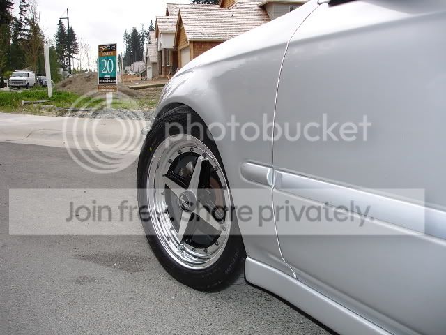

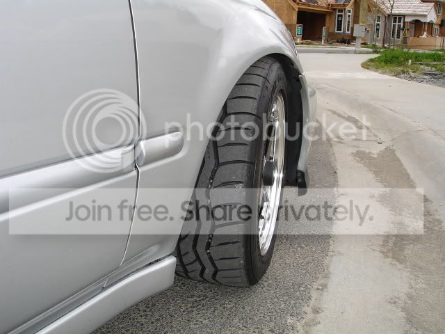

They'll fit ok, but you won't be able to go too low on those wheels. These are 15x7 +38, make you own judgement:

+38mm offset.. I wouldnt go with anything lower then a +40, my gram lites are +45, should beable to tuck them nicely

you can go with a 35mm and still tuck them..i did it a year ago with some konig wheels
