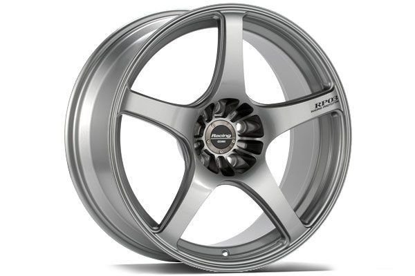

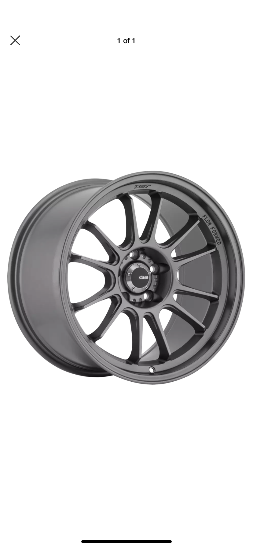

I’ve been browsing and researching lightweight wheels on a more serious note recently because I’m looking into getting a set for my Accord V6 coupe -2013.
Anyways I’ve been looking at Volk TE37s since I was 16 and just dreaming after I see the price of brand new individual wheels. I’ve seen brand new individual 17x8 TE37 wheels go for +-$1000 on eBay and other websites and I’m sure they are worth that. I’ve been lucky to find used sets of 4 for +-$1500, but they’re used, so they usually include dings, scratches, or good ole curb rash. Volk TE37 is the most prestigious lightweight wheel that I personally know of and they are priced accordingly, so I’m honestly scared of owning them. I kind of fear messing them up.
I’ve been looking at 17x8 Enkei RPF1s, 17x8 Enkei RP03s, 17x8 Volk TE37s, and 17x8 Konig Hypergrams. I’ve been comparing weights.
Here are the weights for comparison.
  • 17x8 Enkei RPF1 +35mm offset: 16.1 lbs
  • 17x8 Enkei RP03 +40mm offset: 17.9 lbs
  • 17x8 Volk TE37 +33mm offset: 16.53 lbs (there is also a magnesium version of the TE37 wheel that weighs less and costs more)
  • 17x8 Konig Hypergram +35mm offset: 16.3 lbs
I've started to like the look of these Konig Hypergram wheels. But you pay for what you get, I know... I’ve read reports of all wheels cracking and bending. None of these wheels will be bulletproof. I’m sure TE37s are the most reliable don’t get me wrong.
I would be daily driving with these wheels. I would rather daily drive Enkei or Konig instead of Volk TE37s. Enkei and Konig are selling brand new sets 17x8 for around $1000~ and I’m thinking of going Konig or maybe Enkei.
Anyways, please give your experiences, history, or knowledge with any of these wheels. If you notice any errors, let me know. I thoroughly researched and checked the weights as I entered them. Let me know what y’all think!

Simply from a cost analysis, nothing competes with the Konig's. They're the cheapest of the lot, and also provide almost the lowest weight at the size requested. Plus, I wouldn't really daily drive a set of TE37's unless I had money to throw away. Track driving and show cars are more its place then the every day grind. I ran Hypergrams for 2 years through some of the worst roads in the country (Wisconsin) and also through salt-road Winters. They held up fantastically well.
