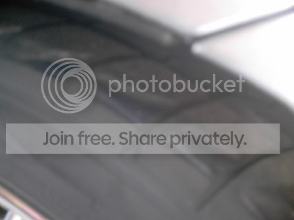

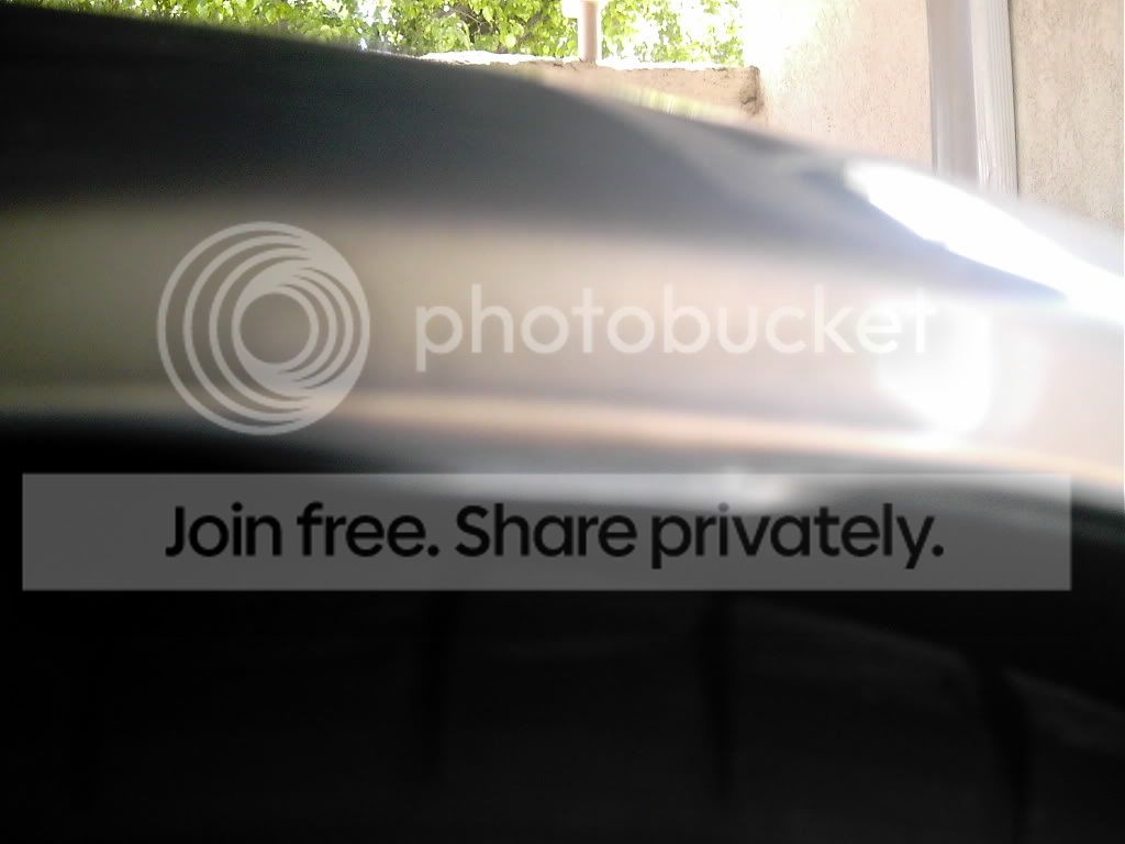

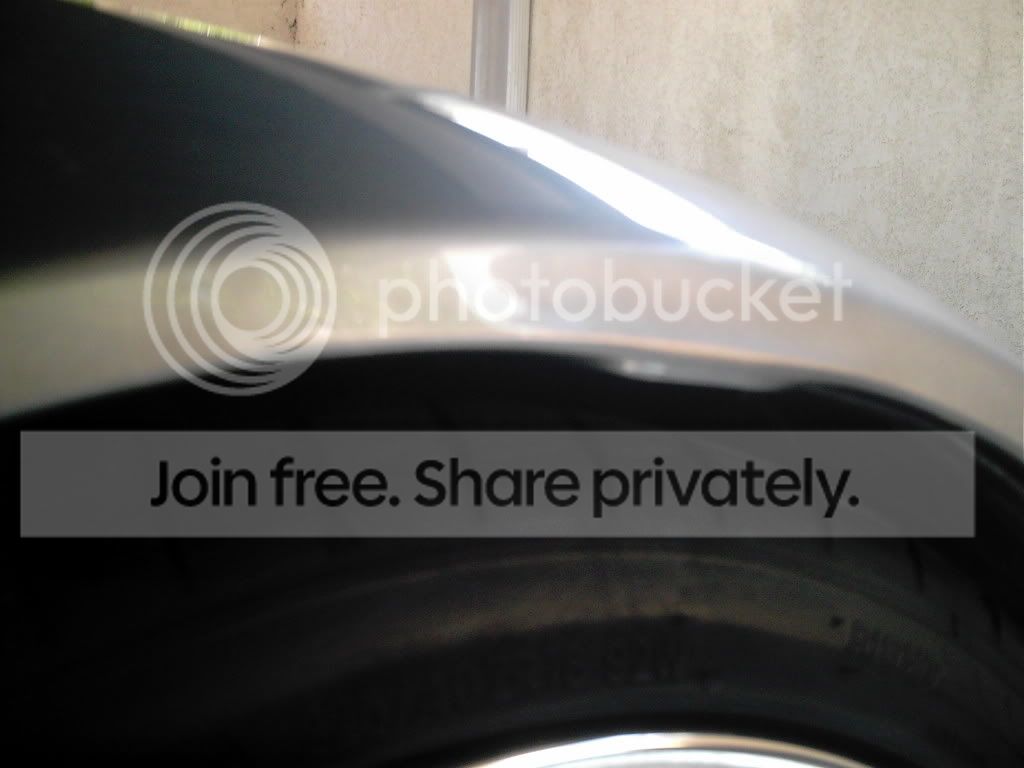

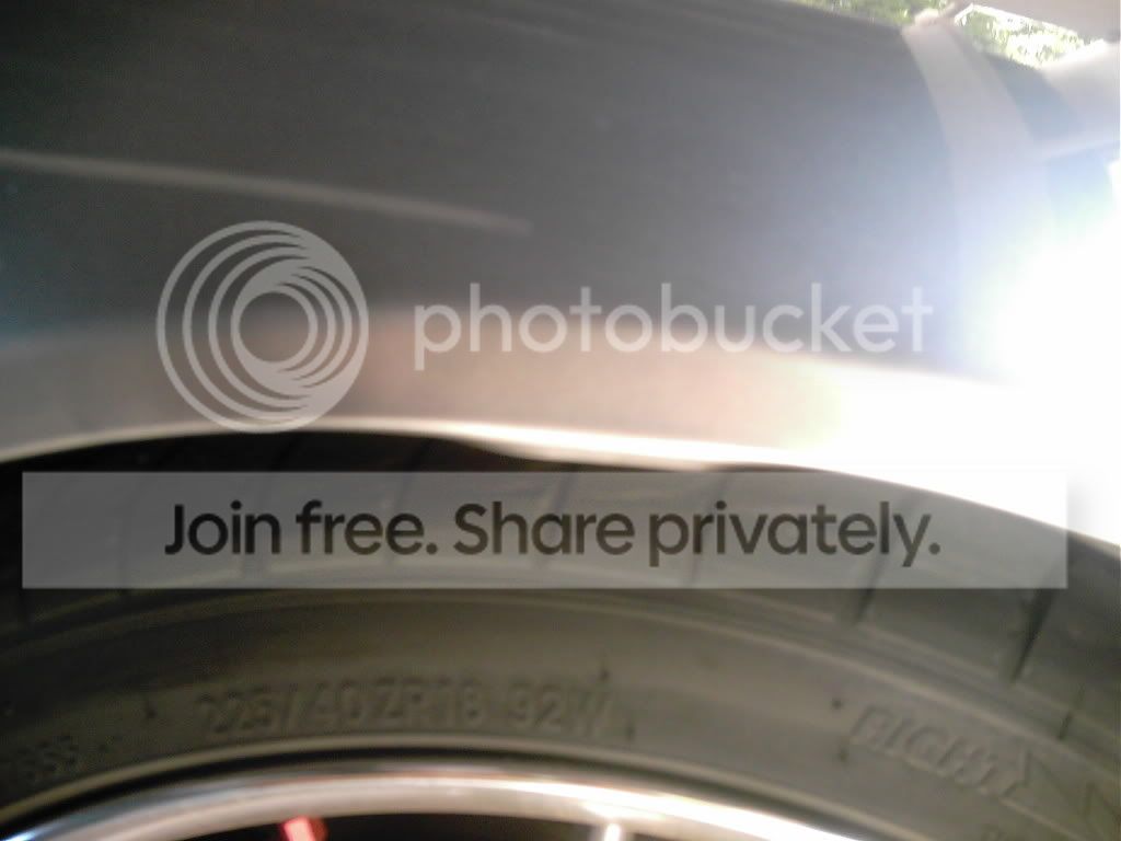

This is what its doing to my tires...
I do car pool with a pretty large man...Could that be the reason?
I'm running on 18's Work Meisters. Offset for the s2k.
Its lowered on tein s-tech. Anyone know the problem?..
Any suggestions or helpful comments is good.
edit. IS the fender fixable? Its just bent..
Thanks..

The first thing I would do is learn to use focus....
You are running 225/40-18, that is the appropriate size for an s2000 (only 1.9% bigger). I don't know why you are rubbing. Rubbing normally doesn't bend out the fender in a small spot lije that. Very odd. Is it only on one side?

hehehe i do need to focus sorry. Its only on one side.. The right side only. This is brand new rubber too.. Should i just put back stocks and live like that or what?.. I love these wheels and they're not suppose to do this..Could my car pool be the problem?

I doubt it's the car pool nor the size of the tire. The size of the tire is almost the same as stock. Is it just that little tab that is rubbing?

the answer to why he's rubbing is quite simple... it's the offsets of the front wheels.... they are differnt then oem's... they are pushed further out.. in return reducing clearance.....
you are also incorrect on the tires.....
if he has an ap1.. the front tires were 205's..
if he has an ap2.. the front tires were 215's..
so also in return he's running wider tires up front + a lower offset + he's dropped (only 1 inch with tein's) + he's got a fat person his in passenger seat (which will lower the car on that one side).. yes it might be very slight but it could be enough to make him rub on turns..... and all those added together = less clearance...

could of things can solve your problem...
1. run more camber
2. run a narrower tire up front.... 215's
3. roll your fenders
4. stop giving the fatty a ride.. lol

how did you lower your car? perhaps you have the wrong spring rate in the front and it's allowing for more travel, riding more soft. and givin the extra load you have with your buddy, i think that may be a problem. in the pic, it doesn't look like your tires are so close that it should rub so easily. just an idea...
