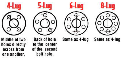

use this guide to measure next time if there arent any other options:
i got the link from here:
https://www.rsracing.com/tech-wheel.html
