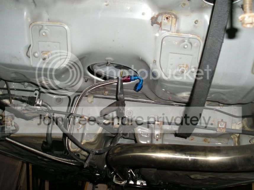

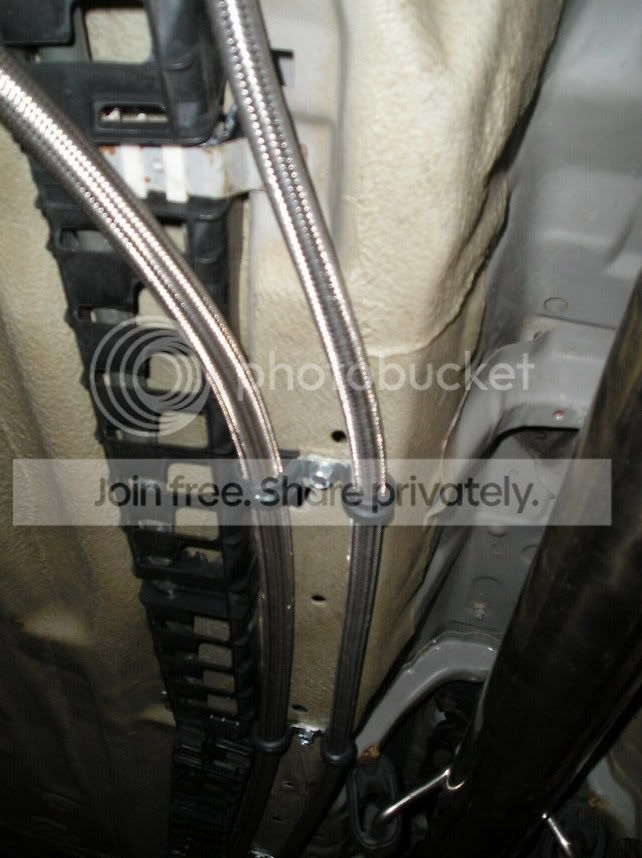

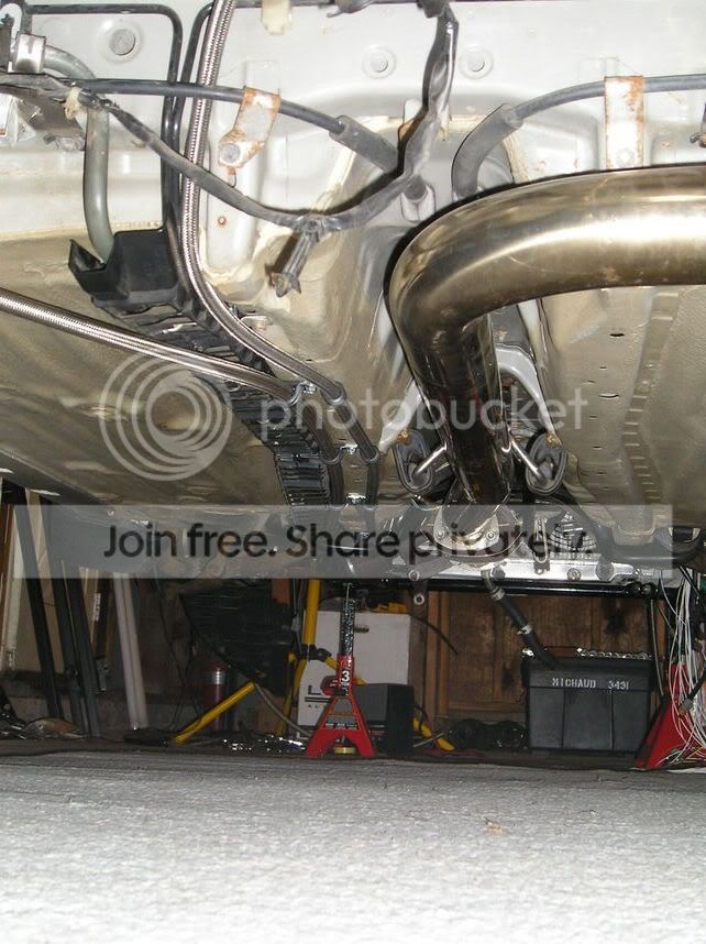

From the fuel pump to rail is -8AN
Return is -6AN
Return to the tank
FPR and fuel sample valve
Hope this helps....

How the hell is the underneath of your car so clean? Do you wax it?

LOL. Well it's a 2000 GSR w/ only 50k miles. It's not driven in the winter either. Never has been.
