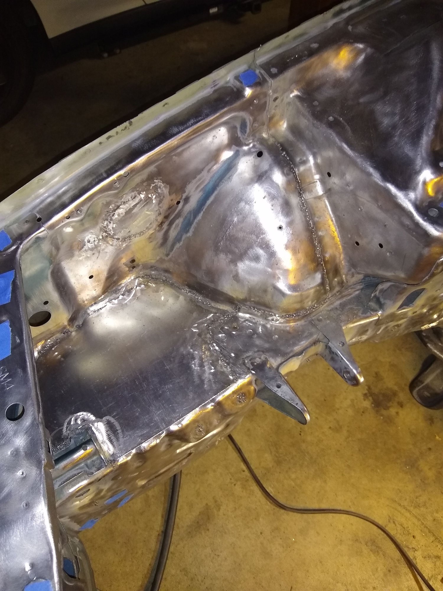

Old Mar 28, 2021 | 05:37 PM
digital sol's Avatar
Posts: 1,620
Likes: 20
Default Re: Why do my welds turn out like this?
Running into the same thing myself. I picked up the following just to work on shaving the bay and perhaps make small brackets for future projects etc.
https://www.harborfreight.com/easy-f...der-56355.html
I realize this is not the best by any means but I wanted to craw before I walk. The reviews were pretty great on it but my only experience is watching some youtube videos where they generally have perfect welds and fail to mention any type of settings utilized.
I got a few holes filled up but during grinding mine look like yours. I also blew a few holes wide open when I got up on the top of the engine bay near the fenders as it seems stupid thin in that area.
I am going to pick up some random bits tomorrow to practice more without creating more work in my engine bay.
What are you using to grind it down afterwards? I was using a 80G flap disc on a grinder but it was taking a bit of time to smoothen it out.
Old Mar 28, 2021 | 05:54 PM
Caoboy's Avatar
-Intl Steve Krew
Community Influencer
Active Streak: 120 Days
Loved
Posts: 6,557
Likes: 197
Return that and pick up this.
Amazon Amazon
Best bang for the buck right now. Pick up a bottle of 75/25 argon/co2. Gas shielded is better for thin sheet metal.
Using fluxcore on sheet metal you really have to dial down the settings in order to not blow through the material. Plus, with the flux and the slag coating, it's more of a mess to clean off, technically you're supposed to remove the slag before attempting another weld/tack, and with thin gauge sheet you're going to be tack stacking.
Old Mar 28, 2021 | 05:59 PM
Caoboy's Avatar
-Intl Steve Krew
Loved
Posts: 6,557
Likes: 197
As far as grinding...
Amazon Amazon
For 4" grinder I use 3m fiberdiscs 60 grit for rough grinding and blending. Let the grinder do the work, don't force it, grind lightly and let it blend out.
If you want to finish blend, we use a dual action sander with 80g stick on discs. You can blend out a really nice finish with that.
Old Mar 29, 2021 | 10:22 PM
Posts: 1,620
Likes: 20
https://www.amazon.com/dp/B084ZRTSBS...AYH5WMTQSZZDWK
Damn, i knew someone was going to say get a different welder. Not sure mine is returnable ill check it out tomorrow. I really just wanted to fill some holes, add a few plates inside the bay and make some small brackets for the fenders/bumper etc. I did tinker a little more this afternoon on lunch and filled a few holes that looked way nicer than the day before however I also still blew through on the fender area pretty bad. Going to cut my losses there and likely use a small plate/fill LOL
Appreciate the info Ill see if i can return this thing and order the one you mentioned.
