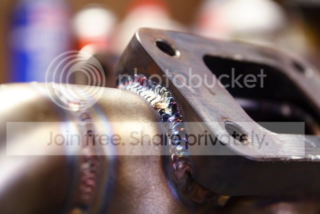

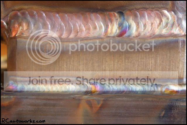

In my experience, it is used to avoid fatigue on thicker, v-groove pipe welds.
Never seen it used on a root, or without filler.
It's usually a smoother motion also. That was just weird...
If you do it the way pictured above, it looks like an aggressive herringbone weave.
I prefer the crescent weave technique myself.

Pretty much zig zagging, search on google you will see steps. As for the point, many people will say it does not help, but everyone has there own methods and feels what is stronger and what not.

Walking the cup is resting the cup on the base metal and twisting it back and forth to make it walk up the pipe. Its hard to explain unless you can get a good look at it.
The point is its usually way faster and more consistent when you welding a heavy walled pipe. Personally i would rather walk the cup because i can get a more consistent bead vs. free handing. But ive seen some amazing welders in the feild who have a steady hand and would rather free hand it. On H-T you wont see it that much if at all (excluding RC whos shitt looks real good) because nothing has a wall thickness bigger then sch. 40.

Well said, and thanks for the compliment. I free hand on thinner stuff, I just feel walking the cup provides a thicker bead and helps spread out the stress on that joint.
