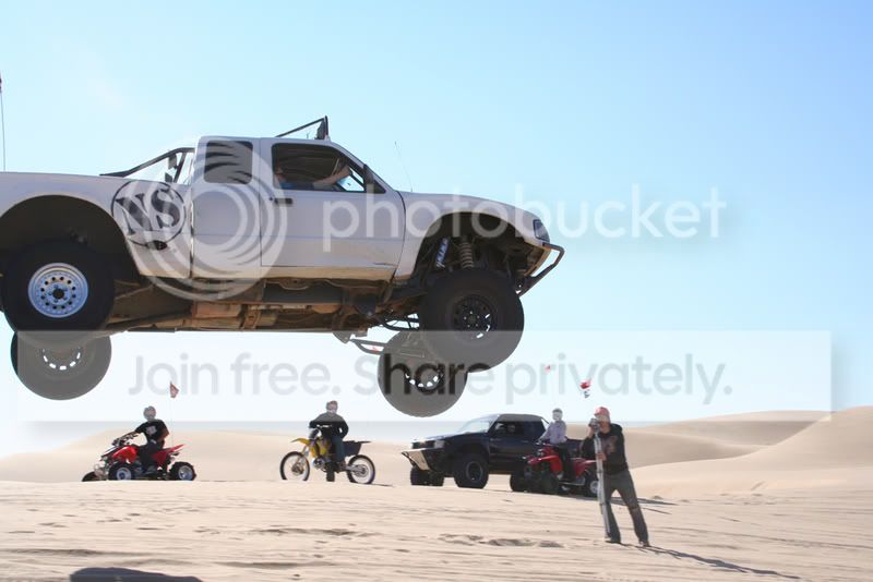

so my friend has his rings in his truck welded in his rear end to make it perma-locked would there be anyway to do this to a honda?
His Truck..
(thats me in the background taping)

the only thing is that when you turn your tires chirp right. because thats what happened in mt friends chirp (see above)
