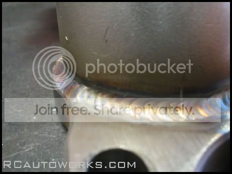

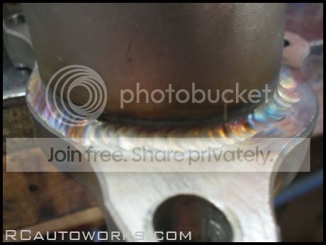

20chf is a little high, and why are you using orange tungsten, use red. I have the same machine by the way, here are some of my welds.

Lets see a pic, a grey weld is either a sign of not enough gas, or to hot.

This was a few days ago, I was using red tungsten, 3/32 308L Filler, 17 CFH and I was using like 80-90 amps for 16 gage.
After turning down the amps today to about 55 and controlling my heat better I was able to do this.
Any insight on what I can improve on would be greatly appreciated thanks guys

that looks pretty good after turning the heat down, add some more filler to that pipe though, maybe a second pass. what does the inside of it look like?

It's not back purged the inside looks pretty good (for not being backpurged), and there's no filler. Here are a couple more pics on the same exhaust set-up..

My biggest mistake i was making and making some of those bird turds you saw there, is that i was cruisin along at 50-60 amps the whole time, and never giving the puddle time to cool down. Today I had the opportunity to speak to a great fabricator and he gave me some insight, in which you see i was able to make the welds look better lol.
