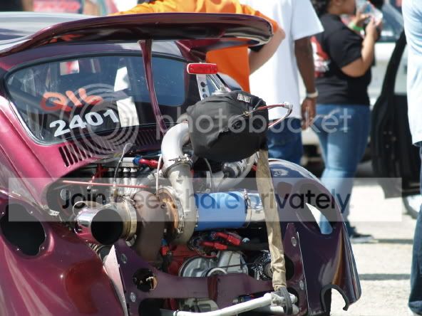

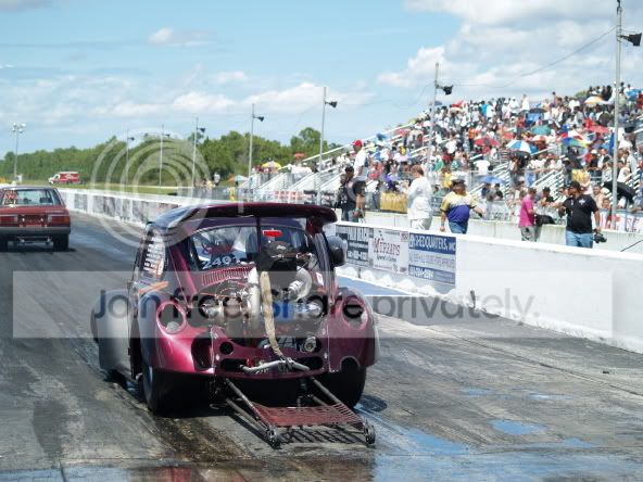

did u make AWD or not. cause me & my buddy are doing that next.
your project looks awsome & clean
here is a pic of our bug that we do drag race
its a 13B cosmo BOOSTED brathing meth

<TABLE WIDTH="90%" CELLSPACING=0 CELLPADDING=0 ALIGN=CENTER><TR><TD>Quote, originally posted by ALL IMPORT &raquo;</TD></TR><TR><TD CLASS="quote">
its a 13B cosmo on meth BOOSTED
: </TD></TR></TABLE>
Uh, I was under the impression that the 20b is the cosmo motor?
Old Jun 25, 2008 | 04:20 PM
  #56
ALL IMPORT's Avatar
Posts: 2,337
From: PBIR once called MOROSO
Default Re: subaru powered bug (chimmike)
no its just the jap spec 13B motor that is the cosmo. the only diff really is the ports are bigger just breaths better & harder 2 find.
also if u are wondering we have gone 8.9s with the current setup & with the new setup we are finishing now we hope to go 7's this would be a world record for a vwbug chassy.
the current car isnt a tube chassy just a rear tubed car. only for the slicks.
we are going to start a tube chassy once we hit 7's
need to prove it will work first. motors dont belong in the rear
