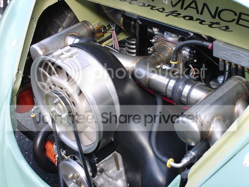

Don't know what that is but im just a mechanic at a vw shop. Im guessing u asked me that because of the stainless i used? I am lucky enough to live around the corner from a company called stainless distributors. It's a giant wharehouse full of stainless and they made the mistake of letting me enter it . So much cool stuff and they laugh at me when i tell them i use it for turbo stuff.

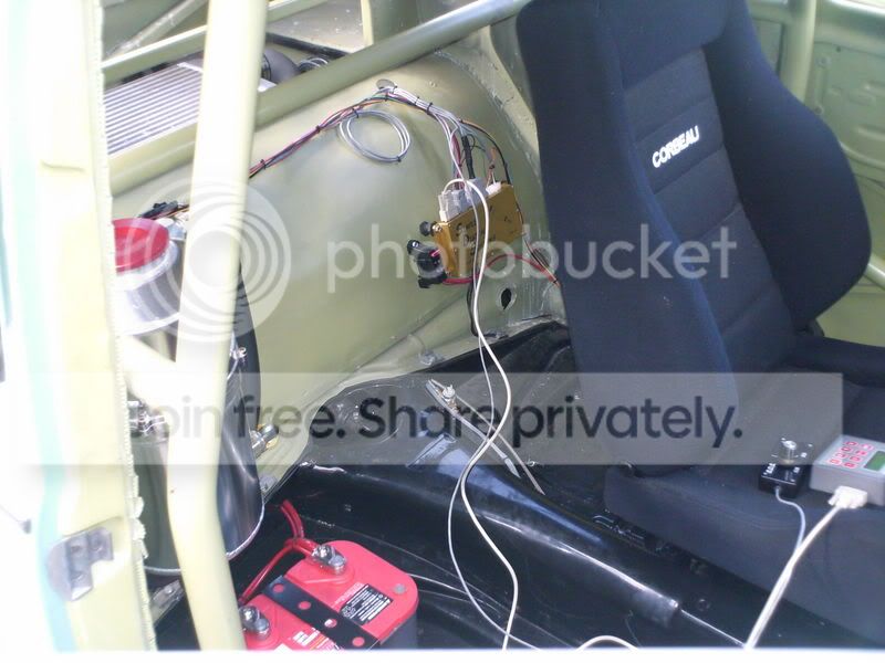

The pedals are willwood. As for the megasquirt i love it so far, although the car hasn't left my garage yet so that might change. I assembled it myself and im runnin edis. I spent alot of time reading and building it and the harness but it all paid off. I literally only had to crank it a couple revolutions and it fired right up. Its megasquirt 2 version 3. As sad as it is i dont have a laptop yet so i have been using a 20 foot serial cable going out to the garage trying to dial the idle in. Hopefully going to pick one up off craigslist tomorrow though.

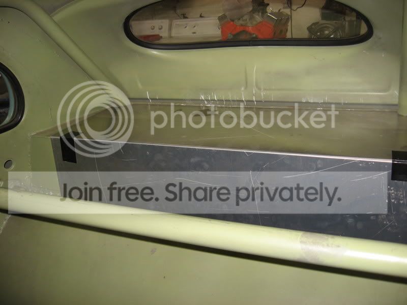

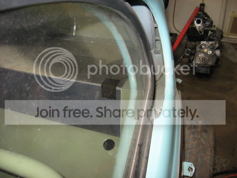

I was waiting for the radiator question....I made scoops in the rear window by tilting the whole inner quarter pannel in that feed an air box. I orginally had the intercooler there when i had the aircooled motor but the radiator took it's place quite nicely. The rad was a jeep cherokee core i made endtanks for. The pics will explain it the best. Im almost done plumbing the radiator but i should be able to take it around the block tomorrow. Oh and im going non intercooled with alky injectoin, i just couldn't make room for a decent intercooler
I can't wait to start tuning this thing. Im shooting for 300 wheel on pump wich should be easy out of a 2.5 and the car should tip the scales at 1900 pounds. The car is being built to be an autocross/fun *** stress car but im sure a few trips down the 1320 won't hurt.
