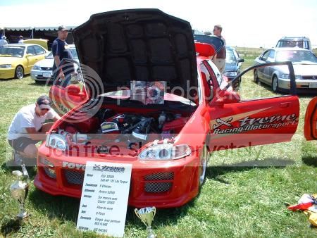

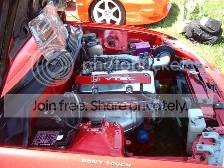

Old May 11, 2005 | 05:13 PM
MidShipCivic's Avatar
Posts: 4,638
From: Altamonte Springs/Orlando, Florida, USA
Default Re: s2000 engine into a 95 civic ?? (jL iLLuZiOnz 9)
<TABLE WIDTH="90%" CELLSPACING=0 CELLPADDING=0 ALIGN=CENTER><TR><TD>Quote, originally posted by jL iLLuZiOnz 9 &raquo;</TD></TR><TR><TD CLASS="quote">well, its not possible yet. being a RWD engine, it takes a lot of fabrication. a couple people have the engine mounted in the car, but not running...yet. this is from what i've read, so if anybody can show proof of this project in running condition, chime in.
is that what the kid said he has? don't believe that ****.</TD></TR></TABLE>
bla bla bla stfu. 2.2 S2k motor is also called an F20 F22 depending on year.
Silver Civic Coupe also has an s2k but its a drag car.
1 street EG I kept a picture of a while ago.
