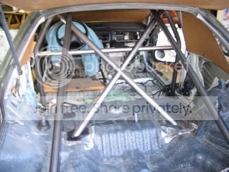

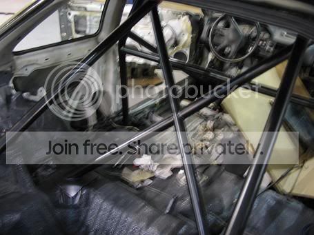

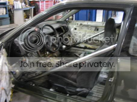

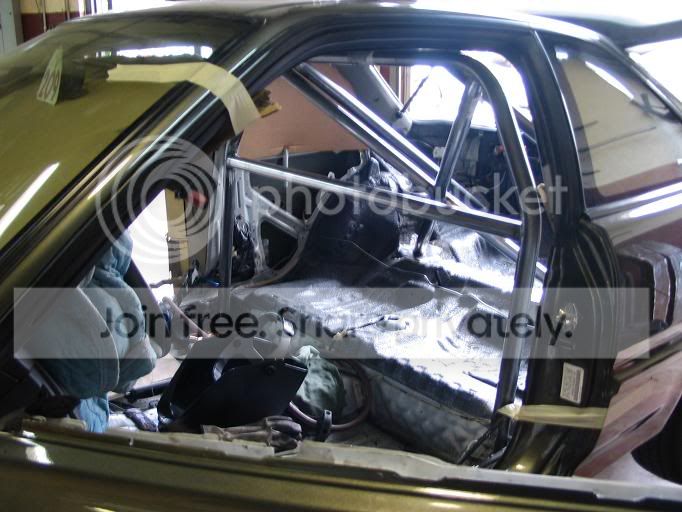

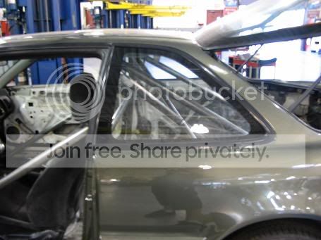

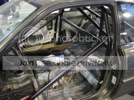

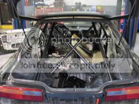

And here is why I originally got the cage. It's N/A now but still looks bad ***.

^ Very nice work Hondatec That isnt a s&w is it and did you do that yourself?
Old Dec 19, 2006 | 07:10 PM
Hondatec38's Avatar
Posts: 1,413
Default Re: S&W rollcage question? (siblues)
That is in fact an S&W. I however cannot take credit for the beautiful installation of this masterpiece. Kressman Race Cars in West Chester, PA did the install. The X-Brace is optional and he did the small bends on the ends for stability and easier weld quality. That was done on the door bars as well. My hoop was preloaded (bent outwards slightly to the b-pillars) before welding to the floor and the harness bar went in after that. This guy is a chassis genius.

Very nice install. Worth every penny.

<TABLE WIDTH="90%" CELLSPACING=0 CELLPADDING=0 ALIGN=CENTER><TR><TD>Quote, originally posted by Hondatec38 &raquo;</TD></TR><TR><TD CLASS="quote">That is in fact an S&W. I however cannot take credit for the beautiful installation of this masterpiece. Kressman Race Cars in West Chester, PA did the install. The X-Brace is optional and he did the small bends on the ends for stability and easier weld quality. That was done on the door bars as well. My hoop was preloaded (bent outwards slightly to the b-pillars) before welding to the floor and the harness bar went in after that. This guy is a chassis genius.</TD></TR></TABLE>
whats the purpose behind pre-loading the bars before welding?

To be perfectly honest...I have no idea. He just told me thats what he did. Im sure there is a good reason though.
