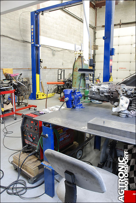

Post pics of your purge setups. I'm thinking of running a line mounted to the table with an on/off switch with regulator in the table for easy access so I dont have to constantly go to the tank.

That is exactly what we have where I work. Works great, do it

My setup is basically a -4 AN line from the dual regulator to a Swagelok valve mounted to the table. Works great, I really love having access to the valve right there. I can even lower the flow by watching the ball valve and adjusting the valve for when I get to the end of a runner ...

So simple and smart. Im gonna have to set that up at the shop.
