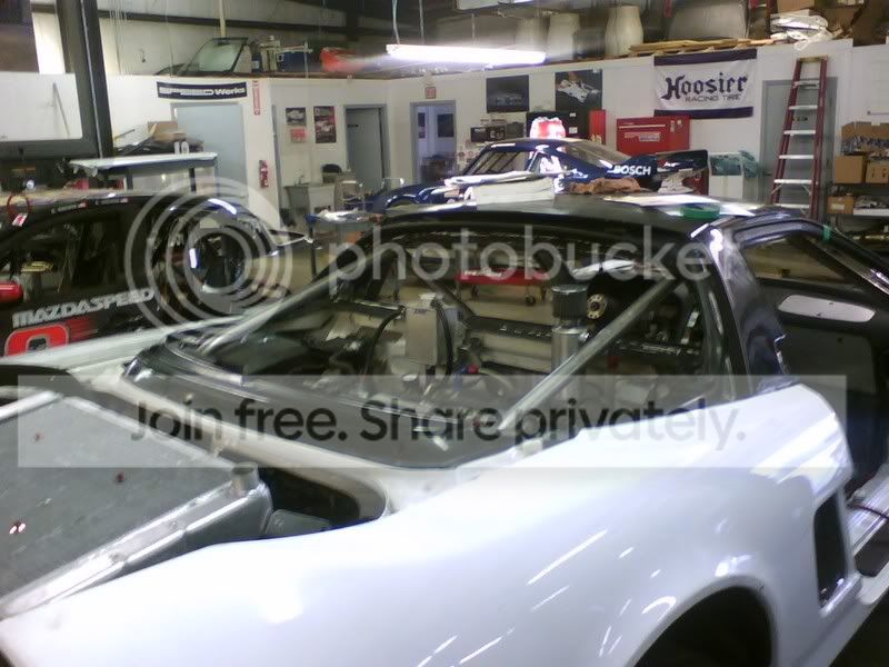

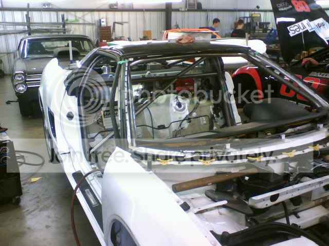

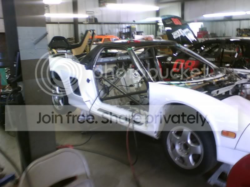

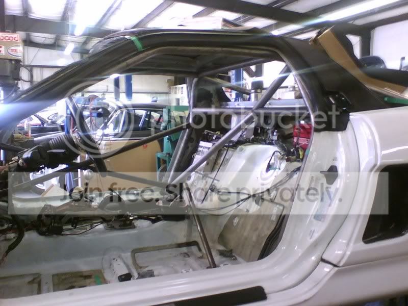

I already posted this in the NSX forum, but I spend more time in here...thought id share. The pics are kinda crappy, but I think they speak for themselves...more progress has been made today, but I dont have any more pics yet, but I will update

Out of curiosity, Do you have any plans to wall off the engine compartment for safety?
Looks good so far!
Old Sep 24, 2007 | 08:50 PM
MajorPayne's Avatar
Posts: 1,521
From: United States
Default Re: NSX cage work (Niles)
<TABLE WIDTH="90%" CELLSPACING=0 CELLPADDING=0 ALIGN=CENTER><TR><TD>Quote, originally posted by Niles &raquo;</TD></TR><TR><TD CLASS="quote">Out of curiosity, Do you have any plans to wall off the engine compartment for safety?
Looks good so far!</TD></TR></TABLE>
well theres a firewall there...but i assume youre referring to the area where a window used to be? there will be a lexan window there once its done

how is it attached to the chassis?

<TABLE WIDTH="90%" CELLSPACING=0 CELLPADDING=0 ALIGN=CENTER><TR><TD>Quote, originally posted by xci_ed6 &raquo;</TD></TR><TR><TD CLASS="quote">how is it attached to the chassis?</TD></TR></TABLE>
bolted with sandwiched 1/4" plates on the four legs in the cabin, and bolted via plates to the strut towers in the front and rear

is that diagonal one peace or is it cut for the harness bar?
And what happened to the back of the rx8
Old Sep 28, 2007 | 03:10 PM
MajorPayne's Avatar
Posts: 1,521
From: United States
Default Re: (slammed_93_hatch)
<TABLE WIDTH="90%" CELLSPACING=0 CELLPADDING=0 ALIGN=CENTER><TR><TD>Quote, originally posted by slammed_93_hatch &raquo;</TD></TR><TR><TD CLASS="quote">is that diagonal one peace or is it cut for the harness bar?
And what happened to the back of the rx8 </TD></TR></TABLE>
its one piece
the rx8 just had all new rear suspension added...the body work comes off in sections

Are you placing a radiator on top of the trunk? I dont see this working well.

<TABLE WIDTH="90%" CELLSPACING=0 CELLPADDING=0 ALIGN=CENTER><TR><TD>Quote, originally posted by MidShipCivic &raquo;</TD></TR><TR><TD CLASS="quote">Are you placing a radiator on top of the trunk? I dont see this working well.
haha nah, its just lying there...it goes in the front in the stock location, i just had to do some work up there and we are re-routing the radiator hoses in the front

<TABLE WIDTH="90%" CELLSPACING=0 CELLPADDING=0 ALIGN=CENTER><TR><TD>Quote, originally posted by MajorPayne &raquo;</TD></TR><TR><TD CLASS="quote">
Oh I was wondering how you're gonna get high pressure air from there.
Old Sep 30, 2007 | 01:37 AM
MajorPayne's Avatar
Posts: 1,521
From: United States
Default Re: (MidShipCivic)
Oh I was wondering how you're gonna get high pressure air from there.</TD></TR></TABLE>
yeah probably wouldnt work well, but i suppose it could be done
but we dont want to put anymore weight back there than needed, its somewhere in the range of 65% rear/35% front weight distribution stock iirc
