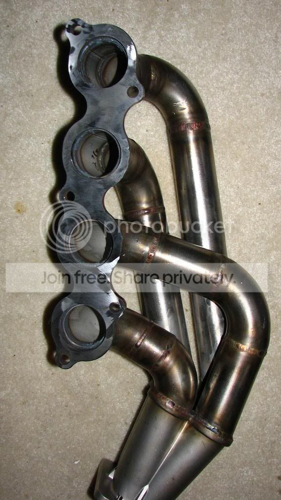

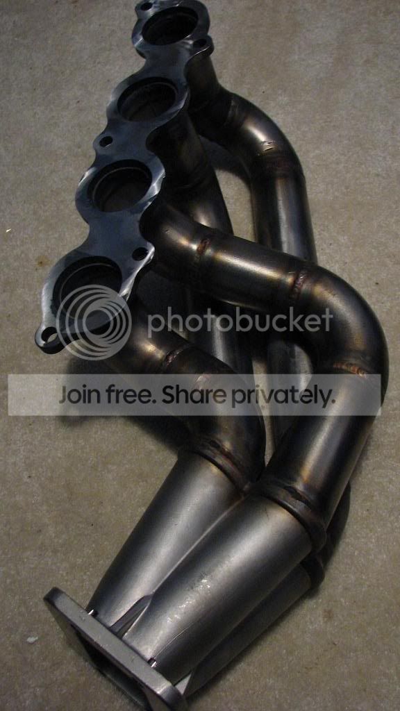

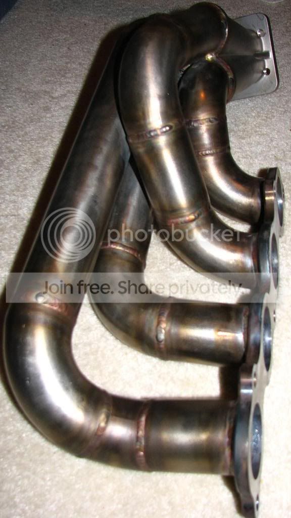

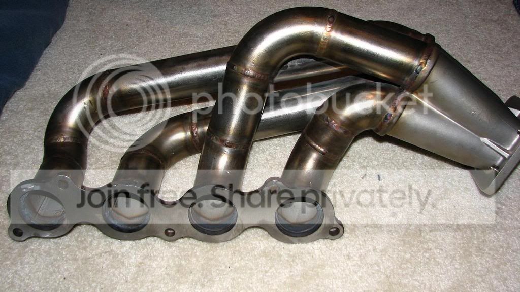

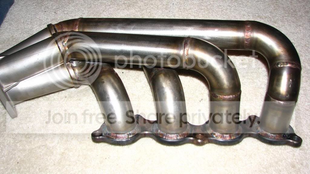

updates!!!
Old Jul 16, 2008 | 07:59 PM
  #35
tepid1's Avatar
Posts: 8,357
Likes: 5
From: CT
Default Re: (9295EJ-t)
Came out pretty good....

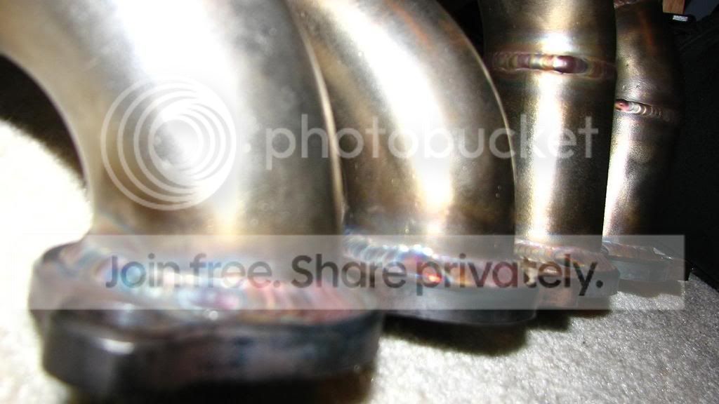

any pic of the procesus of collector welding with your secret thunsten:p
Old Jul 23, 2008 | 08:57 AM
  #39
9295EJ-t's Avatar
Posts: 639
From: Jacksonville, fl, USA
like a finished product? or during pics?
i tried to get a good pic of in between the runners... but it wouldnt come out... terrible lighting in there.. and the flash got me no where...
