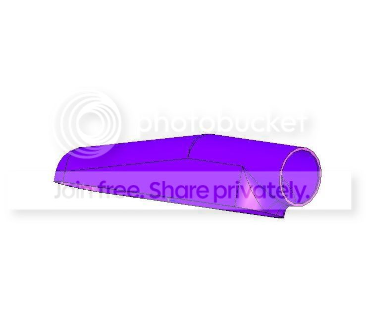

This is the plenum design I will be using for my new upcoming intake manifolds (b/d/k/f20c/f22c/h22)

finished tacking up the plenum
man that thing just about swallows the factory plenum on the s2k
-James

I can't find the pics, but that looks exactly like Full Race's hand made manifolds

you should build a form block james. you could come up with something that would flow better than that i'm sure. it looks like a good start though.

too bad you cant really form 1/8" thick material
and 1/16" is a bit to thin to be reliable
Maybe someday I will be baller enough to get them stamped out as a stamped part has alot better finish than a cast part hell I can make the dies myself (well my old man can)

you think a large plennum like that would work well on an na setup? i got alittle scared on going big with the one in my car so i just chopped it up a little and cleaned the inside then enlarged the plennum a little. are you going to dyno one of these on an na setup?

Yes sir should have some dynos of it within the next month or 2 (will also have a dyno of my upcoming header for the car)

Get a hold of some good CFD software like STAR-CD, that will help you shape the plenum for equal distribution, and can allow you to do simulated flow benching.
I've been doing a lot of CFD work with plenum volume, runner length, and plenum shape over the last three weeks on our Formula-SAE motor. A tapered cone with protruding trumpets seem to have the best air velocity.
Generally, you design the plenum via CFD and choose runner length and size by using alternate Helmholtz Resonance methods.
Good luck

All welded up now

Are you planning on grinding the welds flush on the inside? What are your plans for the trumpets (protruding or recessed)?

Yes the inside welds will be polished flat and smooth
Good luck </TD></TR></TABLE>
Are you simulating the actual valve opening events?

Yes, if you need to get very intracate in terms of exacting runner length, plenum volume and shape, STAR is capable of simulating the dynamics of the engine.
However, even with just port entry angle, size, throat dia, and valve size with approx engine HP/TQ and target peak RPM's, you can get within 90% accuracy. And when you are dealing with a part that could potentially go into production for various setups, you do not need to be that exact.
