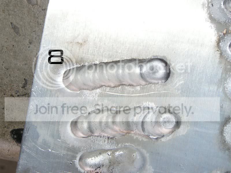

Hi all,
Just looking for some input on my TIG welds.. I've been welding with TIG for all of about 2 hours and I decided to try aluminum. I would like some input on what could help make them better beyond the obvious. I'm most concerned with proper weld cleaning at this point, and was considering lowering the AC waveshape balance (factory setting of 75, down to 65?) to increase the weld cleaning effect. I got the best looking penetration on the final weld #8 (looked very similar to the top side). I'll post a pic of that later if need be..
Setup is Dynasty 200DX, pure argon (20cfm), pure tungsten (3/32"), 5356 filler (3/32") welding 5052 or 6061 aluminum (not sure which because it was just a scrap, but I am guessing the latter of the two) @ 100amps max (75% AC waveshape balance, 120Hz).
I appreciate any thoughts, thanks!

Old May 29, 2006 | 05:26 PM
Motorhead_AZ's Avatar
Posts: 416
From: Tempe, AZ, U.S.A.
Default Re: Learning TIG + aluminum (WhiteSol)
They're too hot. How thick is the piece?
your ac balance is way to high... try it down at 20% or 30%

Default Re: Learning TIG + aluminum (Motorhead_AZ)
<TABLE WIDTH="90%" CELLSPACING=0 CELLPADDING=0 ALIGN=CENTER><TR><TD>Quote, originally posted by Motorhead_AZ &raquo;</TD></TR><TR><TD CLASS="quote">They're too hot. How thick is the piece?</TD></TR></TABLE>
It's thin, probably 0.050" or less. I was thinking it was way too hot also because of the dull look to it. Thanks for your advice!
<TABLE WIDTH="90%" CELLSPACING=0 CELLPADDING=0 ALIGN=CENTER><TR><TD>Quote, originally posted by Lam.N &raquo;</TD></TR><TR><TD CLASS="quote">your ac balance is way to high... try it down at 20% or 30%</TD></TR></TABLE>
Will do, thanks!
Any recommendation on amperage?
get rid of the pure tung.

Default Re: Learning TIG + aluminum (fulldragcrx)
<TABLE WIDTH="90%" CELLSPACING=0 CELLPADDING=0 ALIGN=CENTER><TR><TD>Quote, originally posted by fulldragcrx &raquo;</TD></TR><TR><TD CLASS="quote">get rid of the pure tung.</TD></TR></TABLE>
For a zirconiated tungsten? Please explain
pure has terribul amp carring charateristics, read the miller book for rec on tungsten selection for a dynasty. inverters will like diff tungstens than transformer machines, so I would be careful what you read cause most welding books that are out there are refering to transformer type machines not yours. but i would think you could weld anything you wanted with a 3/32 2% thorated with a sharp tip, with that machine.
<TABLE WIDTH="90%" CELLSPACING=0 CELLPADDING=0 ALIGN=CENTER><TR><TD>Quote, originally posted by fulldragcrx &raquo;</TD></TR><TR><TD CLASS="quote">pure has terribul amp carring charateristics, read the miller book for rec on tungsten selection for a dynasty. inverters will like diff tungstens than transformer machines, so I would be careful what you read cause most welding books that are out there are refering to transformer type machines not yours. but i would think you could weld anything you wanted with a 3/32 2% thorated with a sharp tip, with that machine.</TD></TR></TABLE>
Ah I see, thanks for explaining that. I have the miller TIG handbook which suggested pure tung for aluminum, but did not specify any inverter or transformer based machine differences. I have 4 or 5 types of tung I can try including thoriated.
<TABLE WIDTH="90%" CELLSPACING=0 CELLPADDING=0 ALIGN=CENTER><TR><TD>Quote, originally posted by WhiteSol &raquo;</TD></TR><TR><TD CLASS="quote">
Any recommendation on amperage?</TD></TR></TABLE>
The "rule of thumb" for aluminum is 1 amp per .001" of thickness, so you should be running around 50 amps.
As far as tungsten, use a red one. It works great.
Your filler is too thick for that thin of material. Use 1/16" filler on that thin stuff. The beads should be shiny when done right. Using a Dynasty 300 I use 1.5% Lanthanated for everything, sharped to a point. Pure on the inverters can cause problems with the machines.

Default Re: Learning TIG + aluminum (k24em2)
Hi , is that aluminum anodized? It looks like it ...if it is it might be worth it to get your self some nice clean 6061 to weld on instead of scrap that your not sure what it is.
- Dynasty 200dx uses a Lanthanated tungsten or Ceriated....Miller says not to use pure or anything else on it.
- Turn down the balance to 68 or 65
- don't ball the tip , or you'll run into HF start problems Keep it sharp with a little flat on the end.

Default Re: Learning TIG + aluminum (essex)
<TABLE WIDTH="90%" CELLSPACING=0 CELLPADDING=0 ALIGN=CENTER><TR><TD>Quote, originally posted by essex &raquo;</TD></TR><TR><TD CLASS="quote">Hi , is that aluminum anodized? It looks like it ...if it is it might be worth it to get your self some nice clean 6061 to weld on instead of scrap that your not sure what it is.
- don't ball the tip , or you'll run into HF start problems Keep it sharp with a little flat on the end.</TD></TR></TABLE>
Thanks for the advice and for the info on the tungsten, it turns out that my owners manual fails to mention anything about the wrong types. I found the info online aswell under the miller site - http://www.millerwelds.com/pdf/gtawbook.pdf.
The aluminum is not anodized. However I did apply a deoxidizing cleaner beforehand which accounts for its strange appearance. I have some 6061 that I will be welding up once I get some of the settings worked out.
