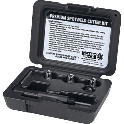

that spot weld cutter is crap IMO. I hate them, then still after cutting them you have to grind the nuggets down before welding. Just makes a extra step. Plus drilling a pilot hole, and that stupid needle always gets stuck....to hell with them. Ill take my Matco bit (pn TH77775 i believe for the set...could be wrong) over that garbage anyday.

I totally agree with swappedcx. The Matco set is amazing for cutting out spot welds. Seriously just spend the money for the matco and you won't be sorry. I Have done 2 sets of quarter panels and 2 radiator supports and my first bit is still perfect.
