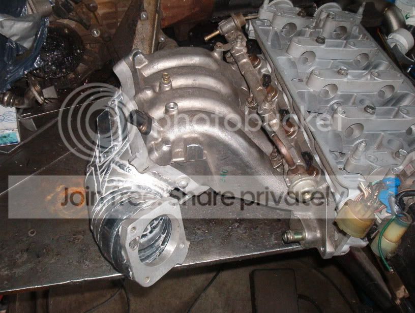

Made this for a 2.1L with GSR head. Doing some testing but a gain of 20whp was seen went from 205whp to 225whp. Not the best looking intake but needed something quick.

yo you got to blend all those welds on the inside , it looks like you welded them through the inside and out side. or it had a supper penetration, im a welder at orlando metal fabrication here in orlando and did many plenums and manifolds in puerto rico and i know what a blended inside weld could do in terms of flow and power.sow try to blend it flush on the inside and youll see better results.... good luck.

these are the before pixs, it is all blended.

did you do anything special to the middle plate and/or runner inlets? good job on the power production.

The mid plate is machined out and the runners are ported.

for 20whp, who gives a **** how it looks
just curious, is the inside of it smoothened out??

Yes.

Monster's design appears to be more well thought... The wide radius entry point where the TB sits would allow much better air distributution than the traditional entry style (cyl #4 gets a wider angle path) -- Similar to the few of the Wilson's intake manifold. The tapered plenum for the 1st cylinder runner is also a good design on Monster's intake, where as RMF's is only a regular capped off end of a pipe
