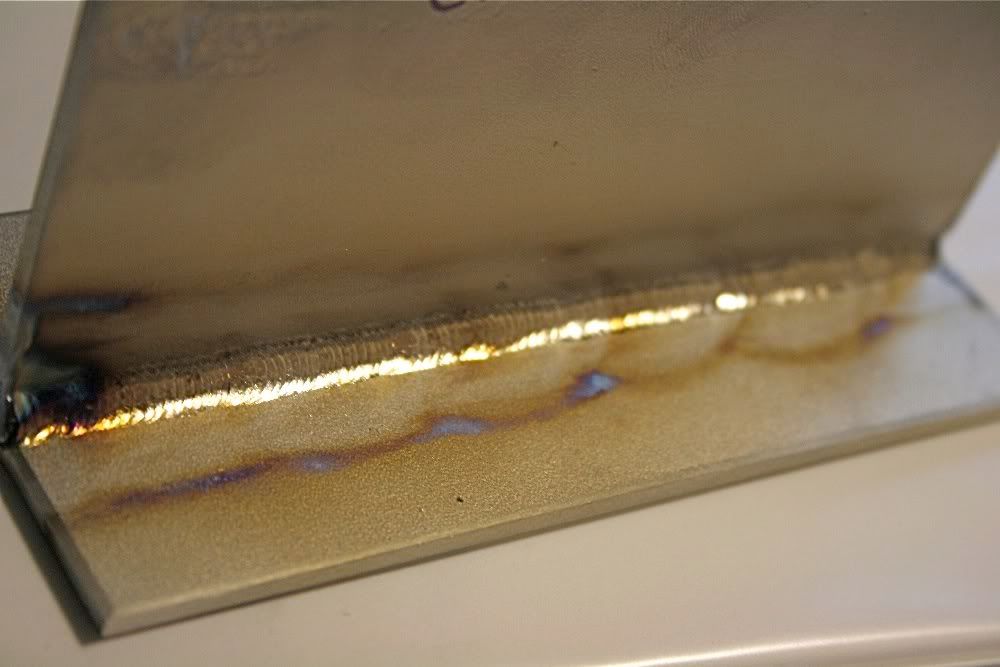

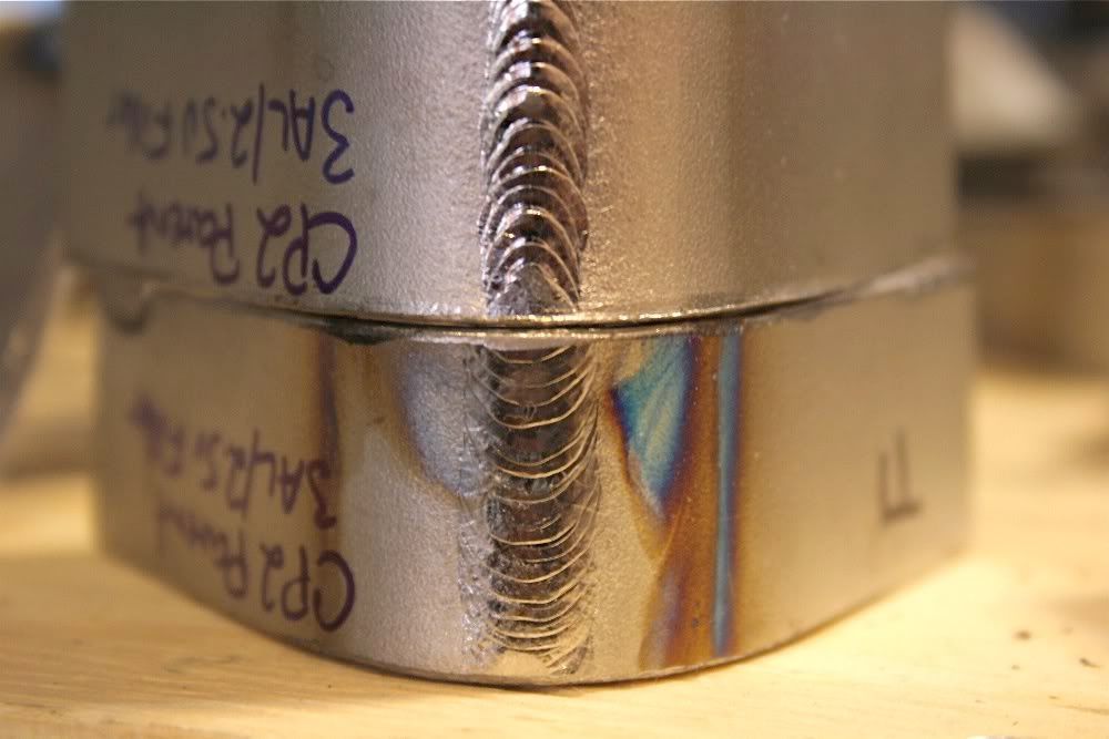

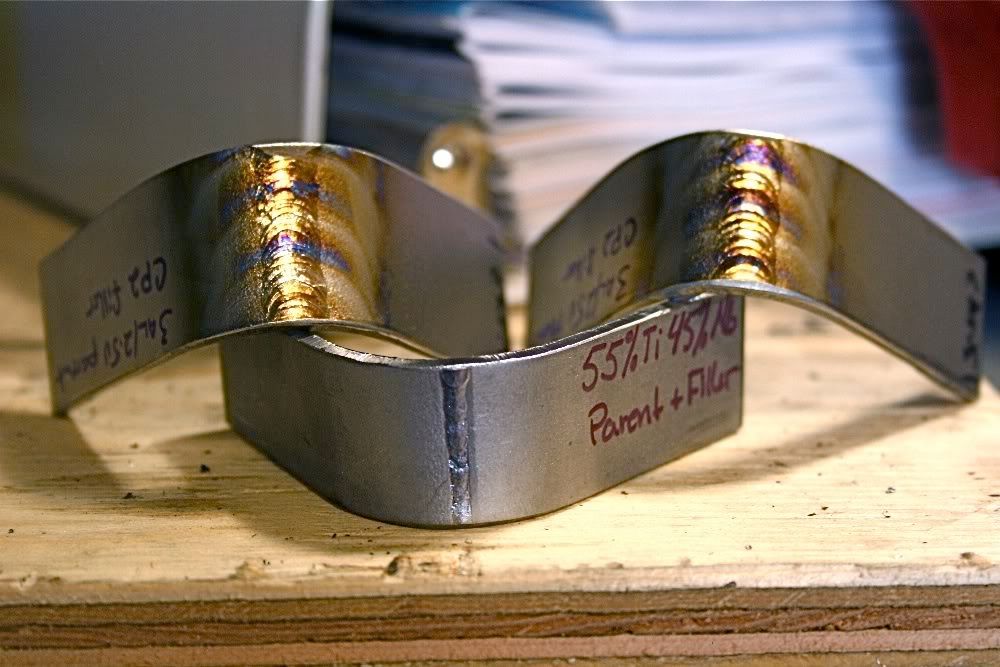

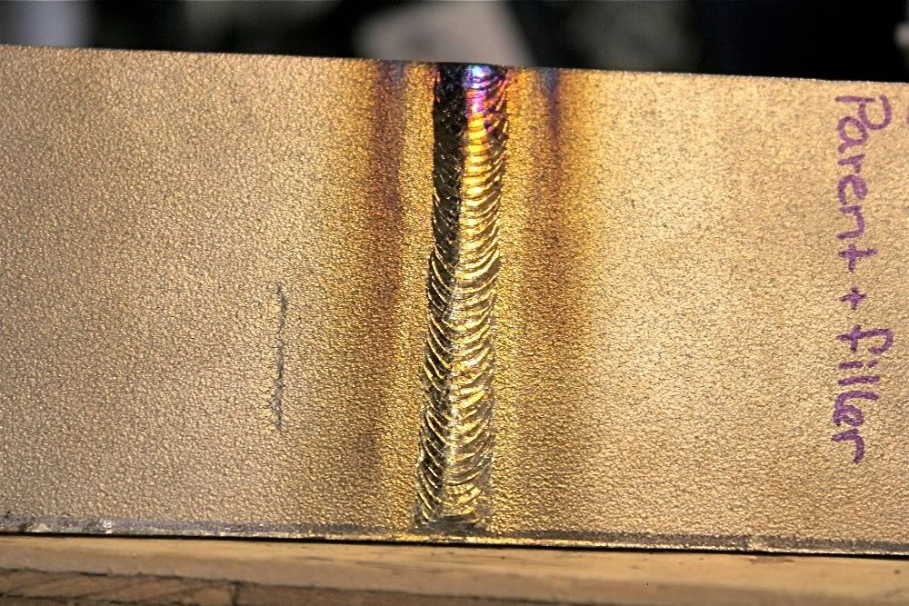

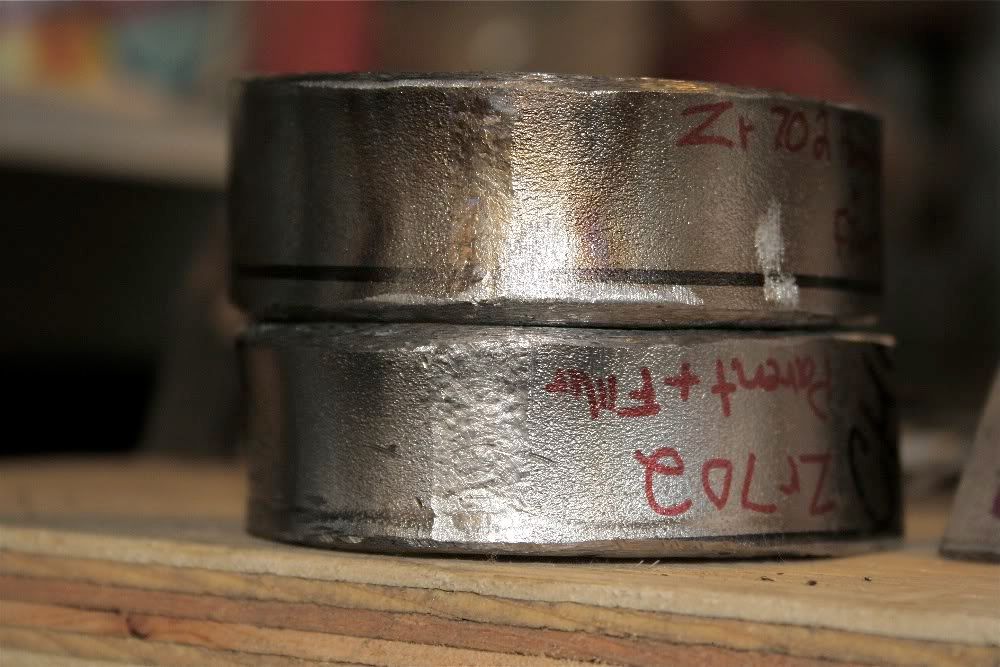

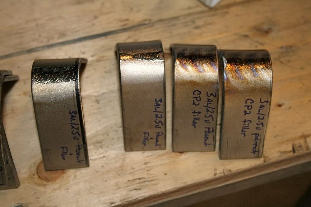

Here are a few of the many test welds. Welded Niobium, Titanium, Zirconium, and niobium/titanium alloys. All bend tested. Tried to get some fancy colours on them to see if slightly oxidized coupons will bend, and they do.
.187" fillet welds on Ti
.250" Zr702 zirconium
.187" groove on Ti
.125" groove on Ti alloy
.125" grooves on various Ti and Niobium alloys
