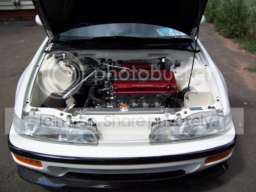

i used a crappy harbor freight wire flux core welder.
did the job just perfect

<TABLE WIDTH="90%" CELLSPACING=0 CELLPADDING=0 ALIGN=CENTER><TR><TD>Quote, originally posted by JDM EJ1 95 &raquo;</TD></TR><TR><TD CLASS="quote">i used a crappy harbor freight wire flux core welder.
Shot with Canon EOS DIGITAL REBEL XT at 2007-07-19</TD></TR></TABLE>
wow that look so clean i guess i go to harbor frieght and get me one thanks for any input and help you guys

<TABLE WIDTH="90%" CELLSPACING=0 CELLPADDING=0 ALIGN=CENTER><TR><TD>Quote, originally posted by Engloid &raquo;</TD></TR><TR><TD CLASS="quote">I've never heard of shaving an engine bay. What does this mean?</TD></TR></TABLE>
closing all the little holes, usually getting rid of PS, AC and stuff.
Basically making everything smooth.
Heres a good example, see how smooth everything looks:
eh, the owner of the car is on H-T forgot his name though
