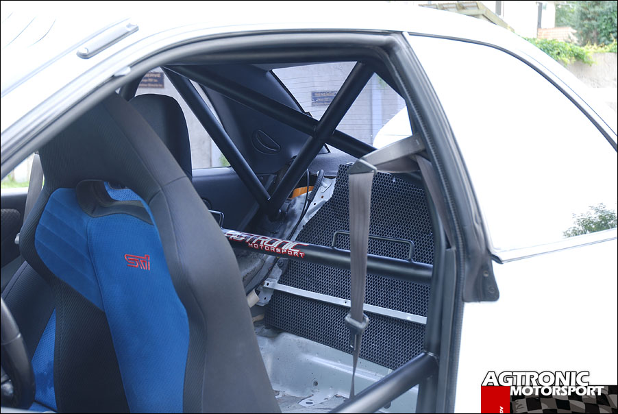

For a street car, don't go more than a 6-point. You don't want bars above your head if you are ever in the car without a helmet.
You can still do quite a bit with 6 points. Do a basic 4 point with a diagonal in the main hoop, then run two bars forward to tie the roll bar into the front of the car. This help with chassis stiffness.

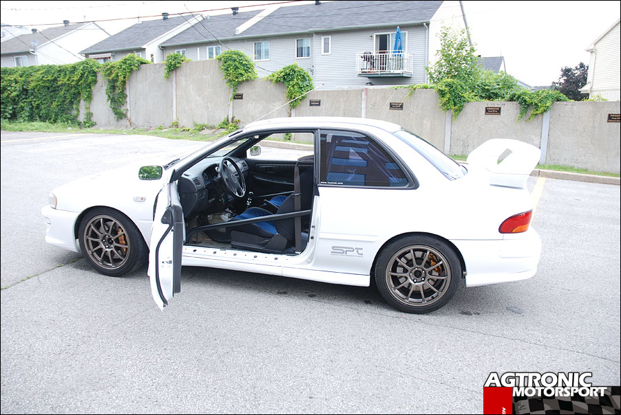

Not sure why everyone seems to think cages in street cars are such a bad thing. The 2mm of plastic covering the b pillar won't be less damaging to your head than the padded tube of a cage.
I'm curious why you hooked the door bars like that. As it stands now they won't do much of anything, in terms of safety or chassis stiffening.
'cause they look cool!
i do them the same way... if somebody is concerned about stiffness and safety... start w a cage from the getgo... a rollbar really doesnt do much in comparison
