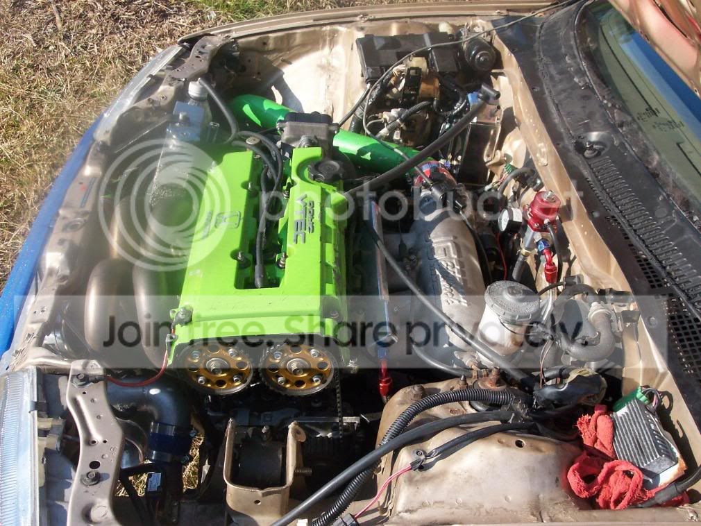

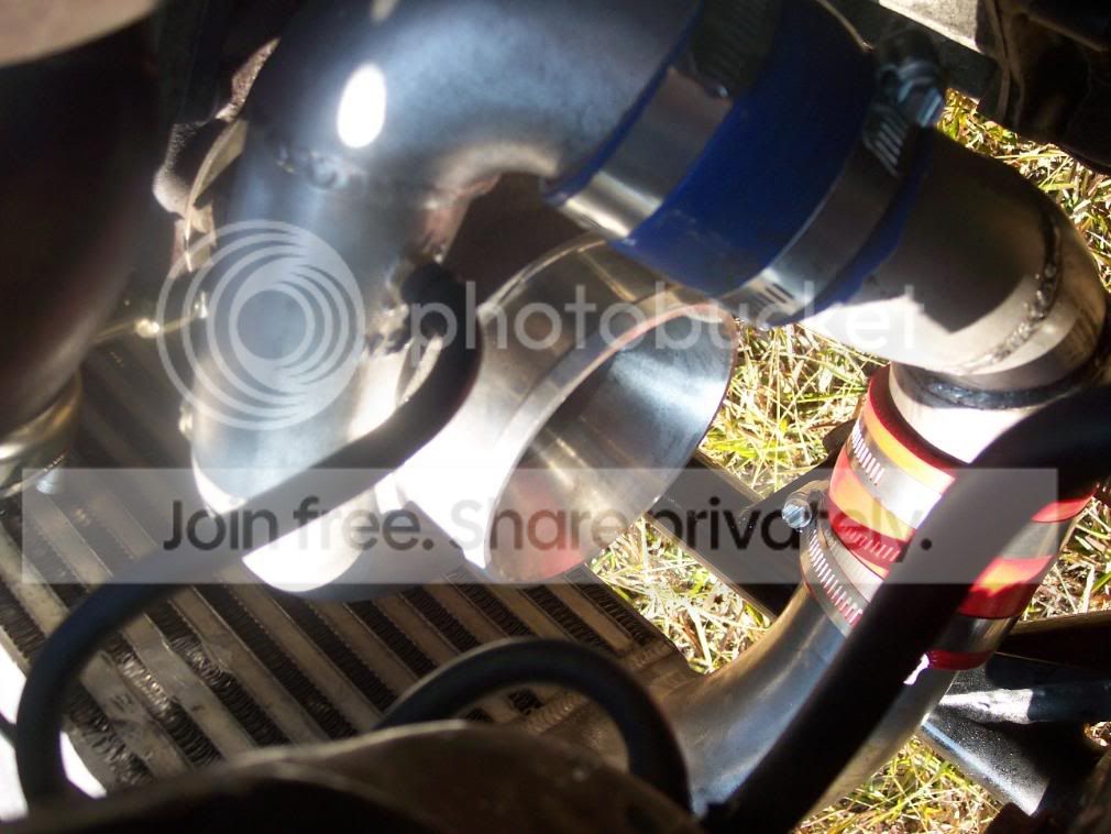

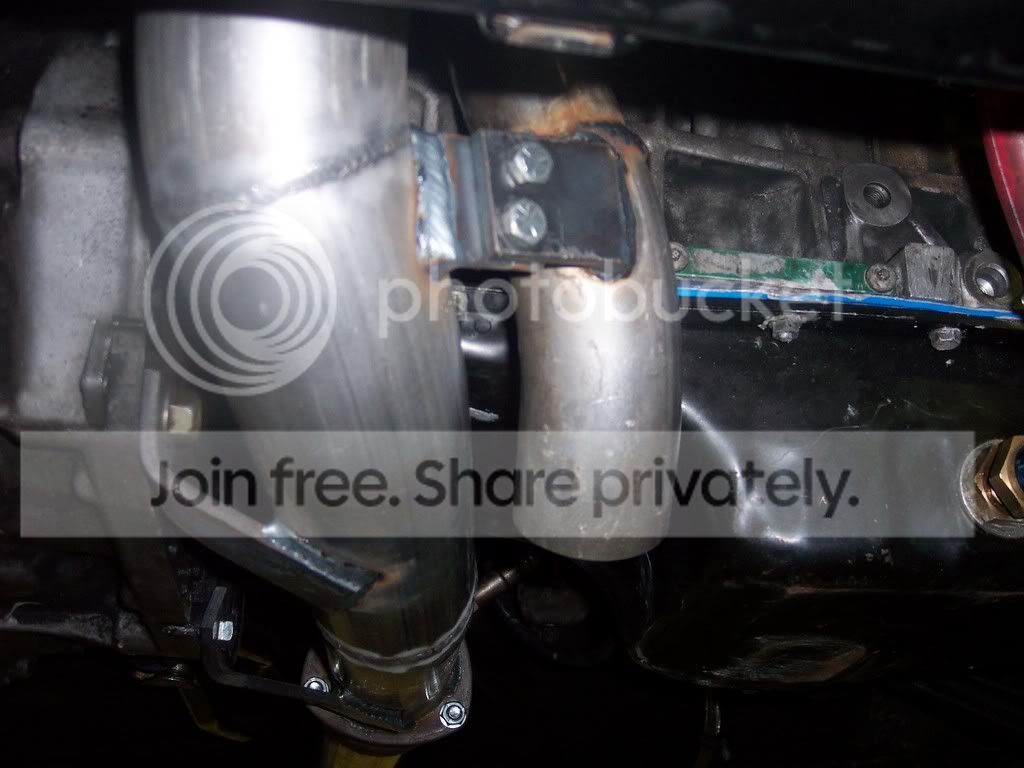

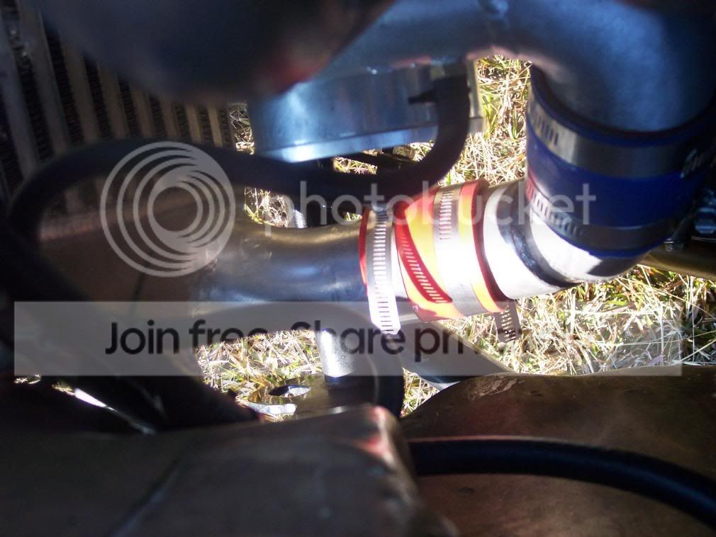

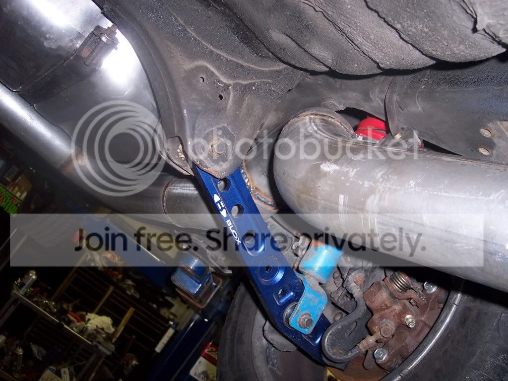

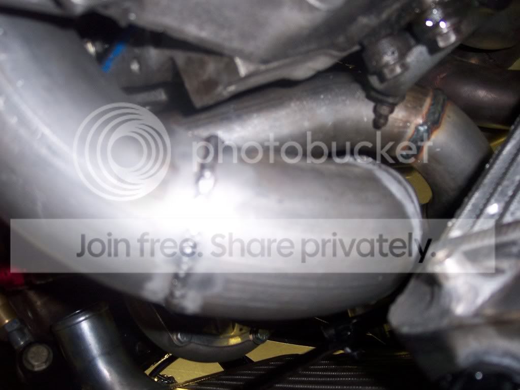

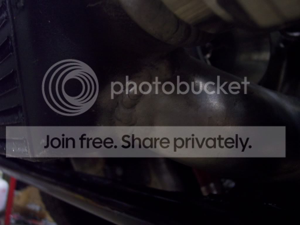

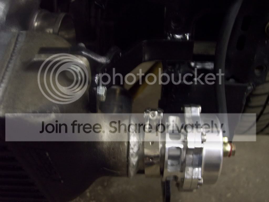

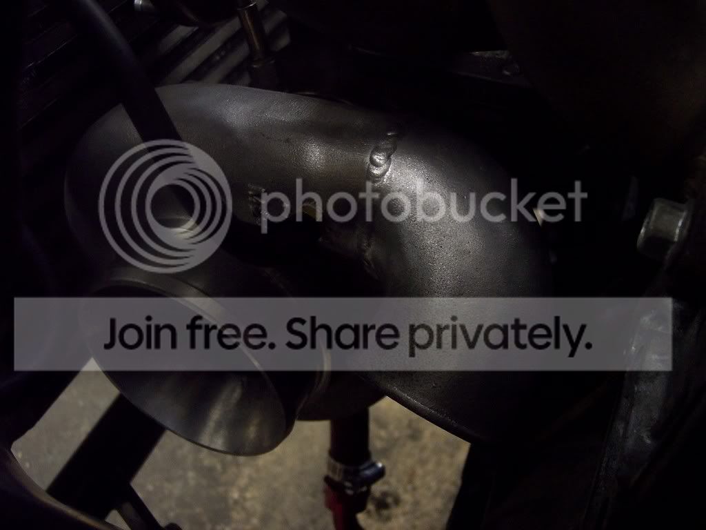

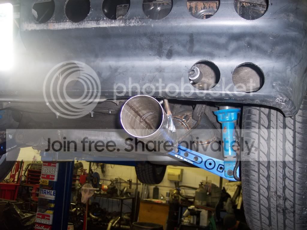

Here is some pics of the fab work on my car... not my work but the shop that sponsors my car... Imports Plus (Bobby Cash)
Backdoor Precision Tial Bov
T3/T67 on a B16a2 90 Civic Hatch
Im gonna post more tomorrow... theres a 90 welded on the turbo as well...

wow. im not sure what to say, as i knew bobby way back in the day. but im wouldnt be too happy with that, it looks kinda rough bro.
is that aluminum piping, welded to aluminum cast?
also that intercooler is way too small for that size of a turbo, i think you will overflow it, and heat soak it due to the size, and that it has a 90 degree going into it.
just alot of different factors play a part in building/designing an efficient intercooler.
i learned the hard way

OK much better pictures, much better lookin as well.
definetley was the camera and the picture quality, not the welds
you need a bigger cooler tho!
who tuned the car, what management is it on?
last time i saw his EK coupe it was running pretty well.(april 07)

From: J Action Ville, nc, USA
Kevin Thackston (Projekteg) Crome pro
Bob got an 11.4 on 15psi on pump out of it...
I dont wana bigger one lol... my front bumper fits soo good now man... Its the 600HP precision so i think ill be good man... this is a stock sleeved motor... just pistons/rods/gsr cams/springs and retainers...
all i want is 600 but kevin has already said if the AIT's get too hot we will back it up...

what compression are those pistons, is this a high compession low boost build?
Old Dec 10, 2007 | 04:31 AM
slow96coupe's Avatar
Posts: 442
its a 10.0-1 motor
Dont know what psi we are gonna run...
We will run how much HP my tuner feels comfortable with.

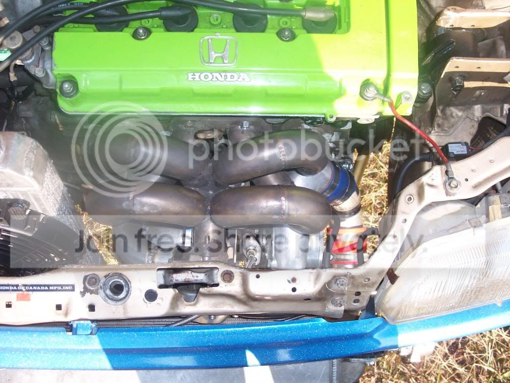

defeats the purpose of having a back door intercooler what you did..
Your suppose to clock the turbo so that the compressor outlet goes right into the intercooler joined with a Coupler not another elbow and more piping.

it's still shorter ********.

Really??
If we did that then we might as well have welded the turbo to the i/c because it was too close...

Interesting color scheme
No problems w/the oil drain where the oil pan is tapped? IMO it looks to low.
The car looks like a blast to drive.

Have not had any problems... I goofed when i tapped it lol but its worked so i cant complain...
The car is rediculous on 1 bar... spins through the top of 3rd with those monster truck tires...
It used to be hot pink and green under the dood

nice setup, i agree that you need a larger IC tho.

A Precision 600HP isn't small.
I think its adequate for this setup.
