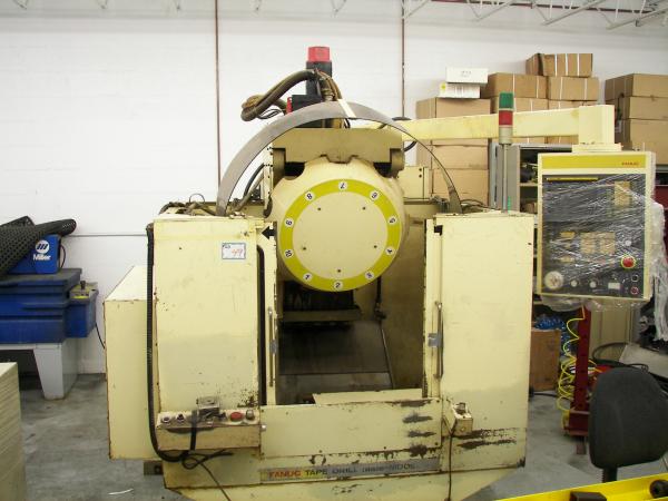

that desktop cnc mill will just **** you off because it wont have enough power and take forever.
If you take your time you can get a real machine for not much
I got a FANUC RoboDrill for $1900, After Rigging Trucking, Electric Tooling etc I had about $1100 more in to it, But I own my own trucks and fork lifts and have connections for stuff cheap. My Steel Stock costs me $.08 a pound, I purchase my Hanita EndMills for $9-12 a lb. I get them from a precision facility and once they got to .001 before the stated size they throw them out
My Costs for a CNC Machine
RoboDrill w/ 4th axis $1900
Cost of Rigging and Trucking 75 Miles $300
(2) Kurt d675 Vises $100
5 Gallons of Blaser Coolant $150
Electrican to Hook Up Machine $300 including wire conduit breaker etc
Used BT30 Tooling and Pull Studs $350
Total about $3000
I still need a subplate, and an upgrade to cam software at an *** hump of a cost prob 5k
Yes my shop is a mess in that pictures because we had to move so much **** to put the machine where we wanted it to be and they big forklift blew a cylinder moving it
