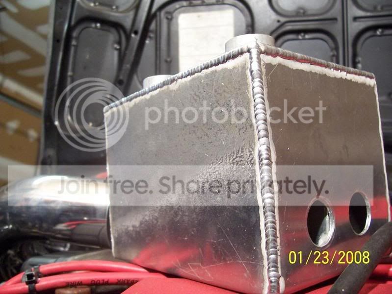

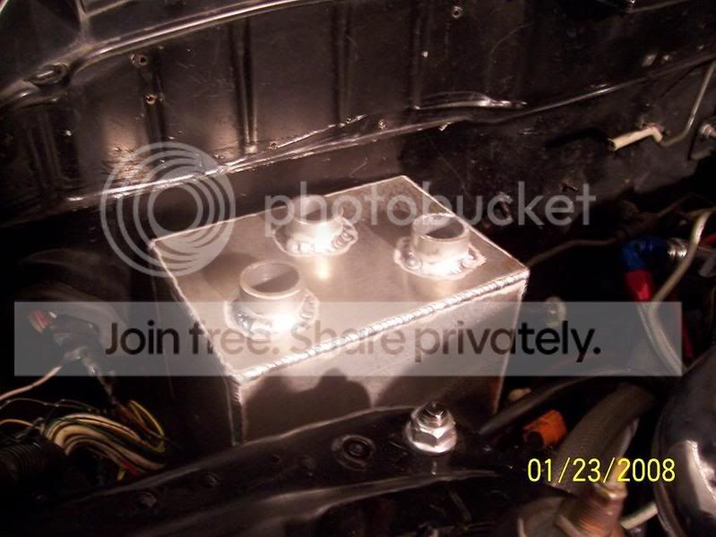

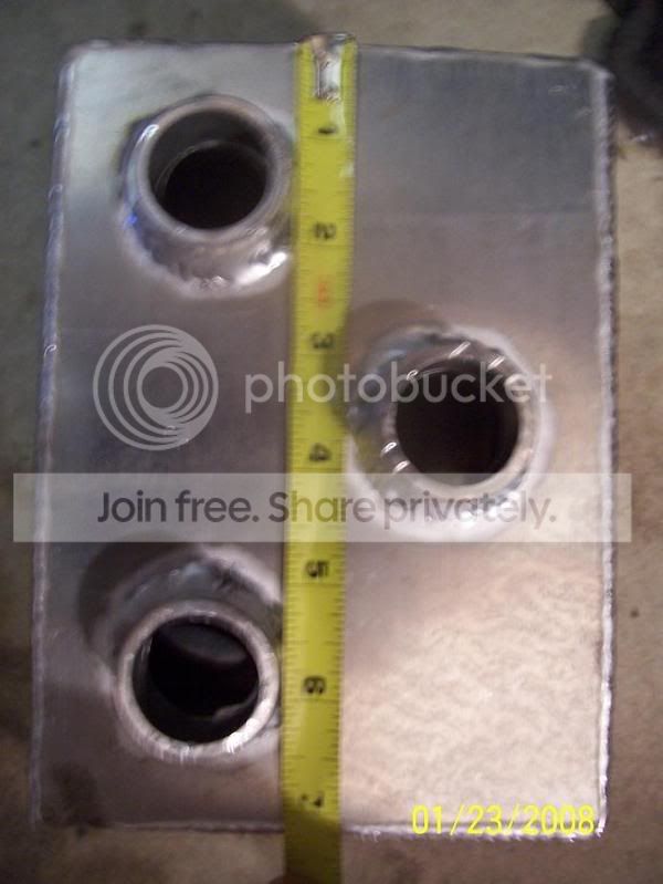

I have been trying to come up with a new catch can idea but it seems T1's is the best design out there, and since my battery is already relocated, and the design is so simple I just made a Battery Box Style Can. As with the endtank I made a couple weeks back, it did all the cutting/bending and my friend did teh Weldin'. The bung holes are not in the final place, I might run 3 off the valvecover and 3 off the back of the block, with the return going to a bung welded on the PCV plug and the 3rd bung being a -12 to the center of the front of the valvecover ( ramhorn makes it hard to run dual bungs on the front). I am also considering making a batch of 20 or so of these, complete with bungs welded where customer wants them for a very good price, this can is just for photo purposes, I got a good price on a sheet of mirrored material and the moroso filters, bungs, baffeling inside etc. I know about 5 guys locally that want one so it might be worth it.
I do not have a battery box in my car to finalize the mounting bracket, so I am diligently trying to find one to finish this thing out, this photo just has it sitting in there loosely

might that be a little bigger than it has to be?...

That is what I am not sure of actually, I thought it was a little small, there is still hood clearance with the filters, that is why I am trying to find a battery tray now, currently there is not one in the car.

looks good I plan on fabbing one myself and have it welded. what thickness and AL is that? Surge
Old Jan 24, 2008 | 10:23 AM
96 GSR-T's Avatar
Posts: 6,381
From: Newark, DE
1/8"

hey man, whats pn the inside of the can? is it just hollow?
or do you have some type of fileterd relase valve type thing in it? always wondered waht was on the inside of these when people made em

Just some minor baffeling to keep things from sloshing around under acc/decel. The final bung will be much lower to minimize how much oil is retained in the tank, my car pushed a good amount while doing a burnout.
