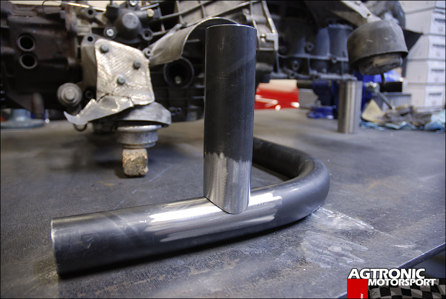

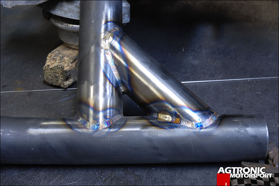

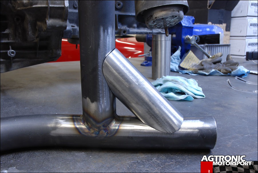

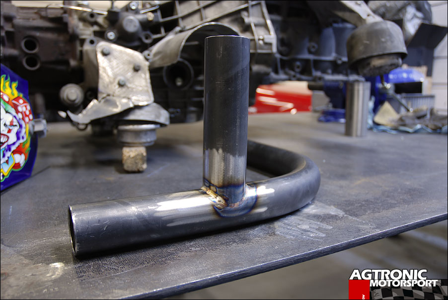

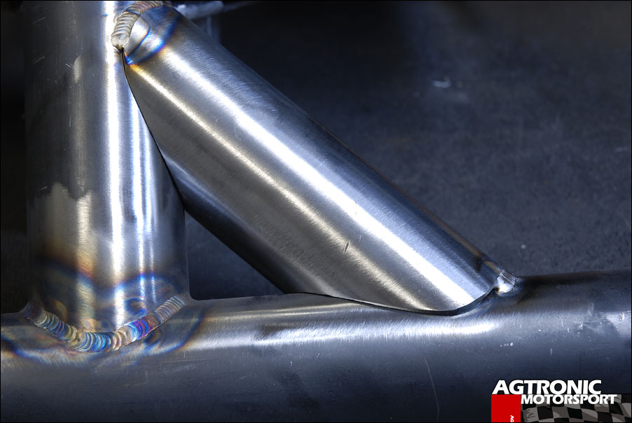

Here are some tests I did today :

Don't forget to grind the thin edges of the coped tubing back to full thickness before you weld it. A lot of people forget this step. Looks good though!
Old Jan 7, 2009 | 06:35 PM
DESTROYER's Avatar
Posts: 622
From: MESA, AZ, USA
Default Re: Cage builders, in here please!
Not entirely necessary with TIG, since you are going to burn away that razor edge anyways. MIG welding, for sure!
