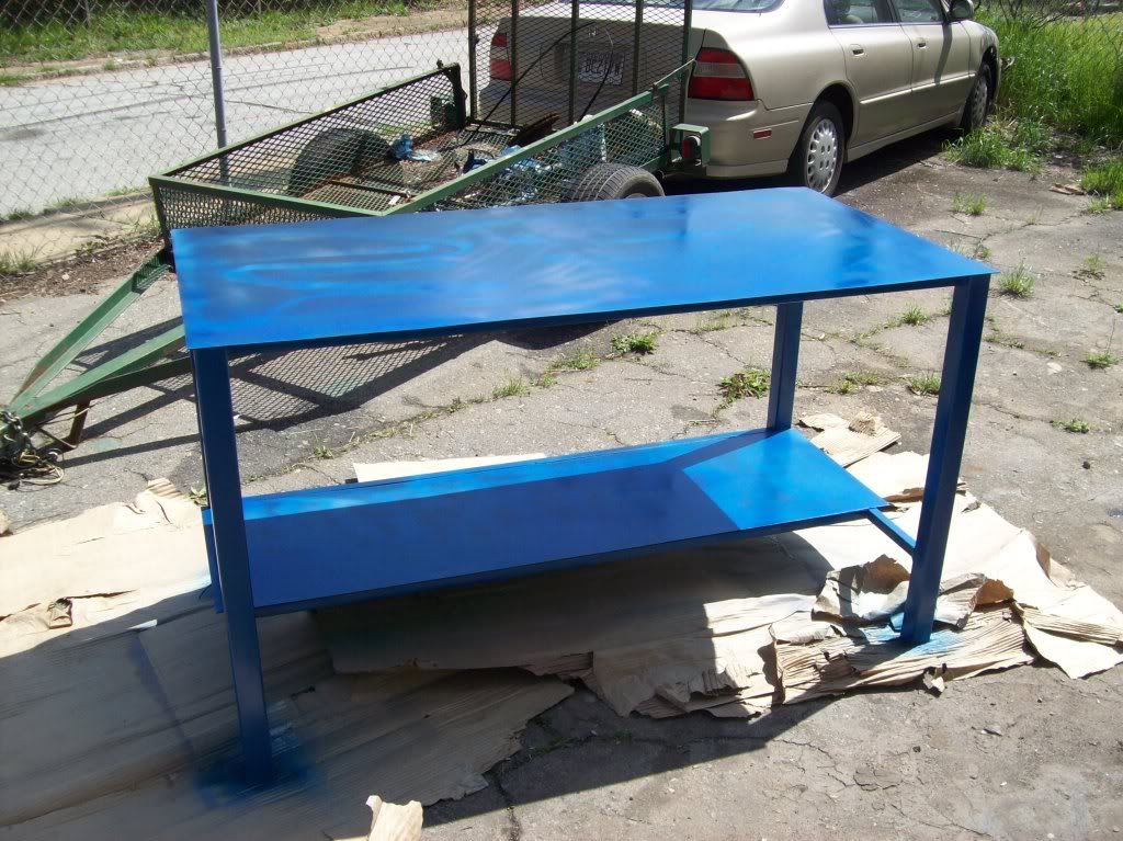

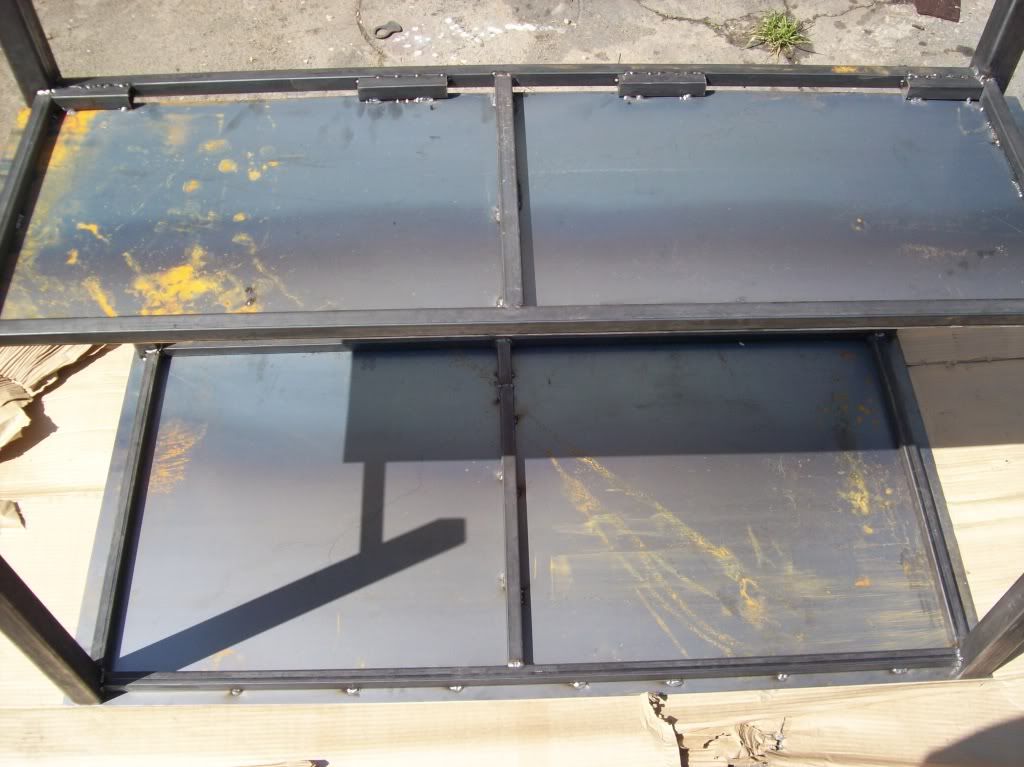

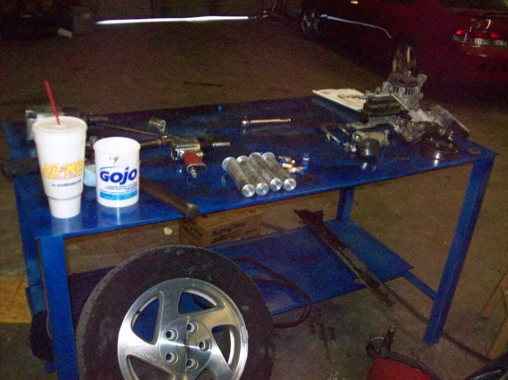

Thanks for all the suggestions. I called the steel supply company and the pricing on materials wasnt too bad so I had them sheet me a 4x10 plate (so it would be a very clean, straight cut) into 2 30x60" and 2 18x60" sections. This should allow me to do 2 tables. Got 2 inch square for the legs and 1" for the supports. I sprayed it with some blue automotive single stage paint(need a little more, can do that later), let it dry and put it to use. Learned a few things but overall I am happy with it. One of my techs told me it was awesome, cant wait to do the other one, may have to wait till the weekend, lol. Here are a few photos of version 1.0:
Underside showing structure:

1 hour after the paint dried:
Any suggestion or critique would be appreciated.

watch for sharp edges
Yeah, that will be addressed in Version 2.0. I would like to round the corners on this one to help out.

Don't paint the tops. All the dealership service benches I ever used had a high grade industrial enamel that put up with a decent amount of abuse...but that single stage you used will probably chip up quickly. Maybe use Hammerite or something else a little thicker, IF you really want paint.
A backsplash around the back and side edges can do WONDERS for a tech. This, with a little lip or tray in the front will keep you from losing tools and hardware.
Otherwise, nice work. I like buying service benches as they are VERY light and can be moved easily, due to the contours of the structure...but they are spendy
