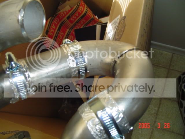

- 'spot welded' with stainless wire
- grind down tacks with a dremel + fiber cutting blade (black ones)
- have someone with experience tig weld it
That's how my unskilled-in-tig-welding-cheapass got it done..
..and aluminum foil and hose clamps for backpurging.
