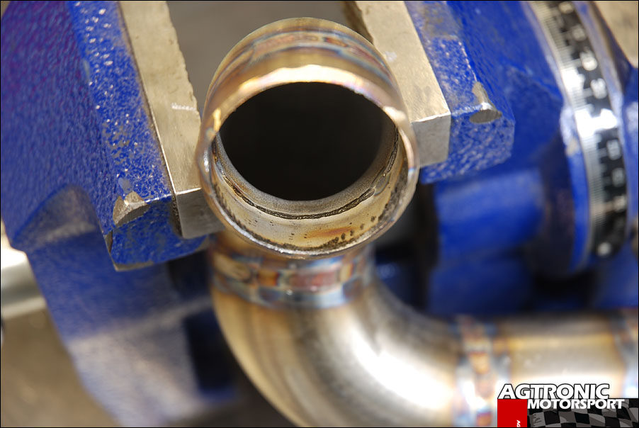

Almost always encouraged on stainless.
Here you can see where gas shielded the inside, and where it did not.

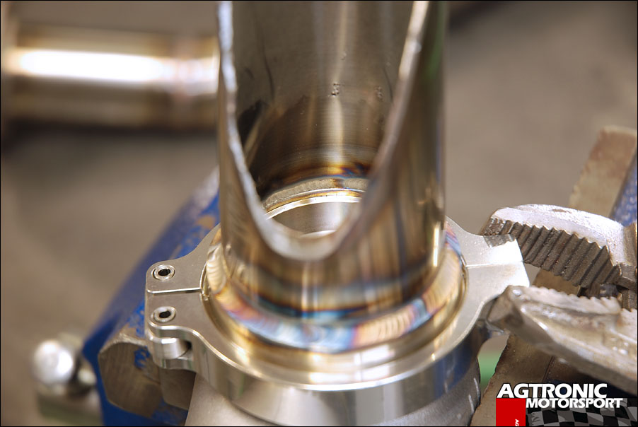

Technically, you should back purge whenever you are going to bring stainless steel to melting point, where its surface will oxidize if exposed to oxygen. If you don't purge the inside of a pipe, you will get a big grey surface that has a crystal-like appearance.
The main idea with purging is that you are purging all oxygen from the inside of the pipe, using an inert gas. In theory, you could acheive the same thing using a vacuum inside the tube, but this would suck in your weld pool. If you were to weld in a vacuum chamber with equal pressure above and under the weld, it would work too. What is important to understand is that the argon is not "actively" doing anything to the metal, it is just forcing out all ambient air from inside the tube. You could use any inert gas you like.
Now, if you were welding critical parts for the aeronautical industry, you would obviously purge absolutely everything, always.
But in the car industry, it's really up to you, and what you feel comfortable with. I personally only purge critical parts such as exhaust manifolds and downpipes. Parts that will be subject to a lot of heat and a lot of vibration.
I do not purge stainless boost pipes, or exhaust systems. For boost pipes, I fusion weld and am careful to make sure to not penetrate the material, to keep the insides of the tube clean. On exhausts, I use filler rod and. This is what has worked for me. I have never had a single boost pipe or exhaust system crack. Ever.

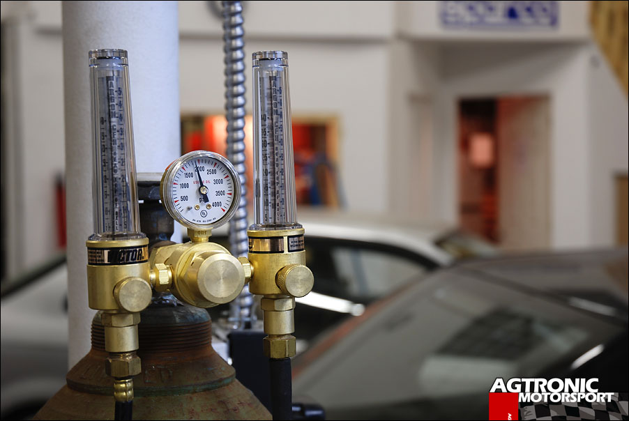

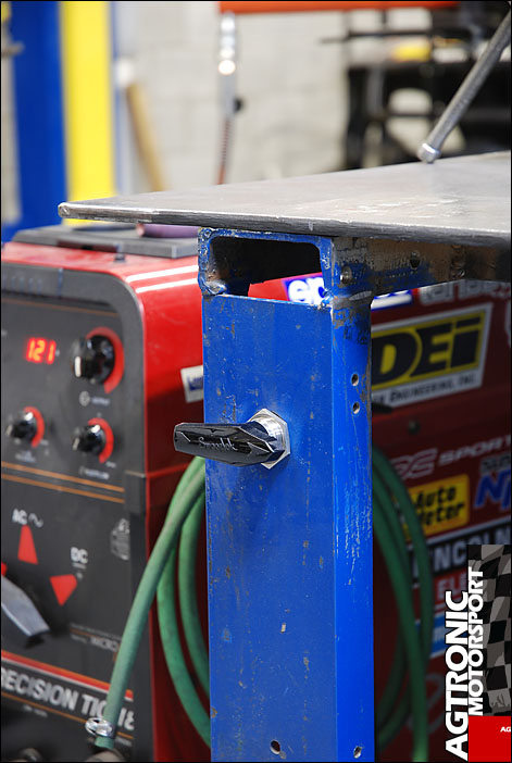

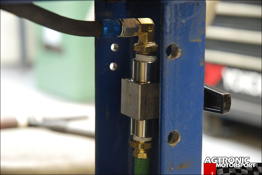

As for a setup. Ideally, you want a second regulator so you can know how much flow is going into the pipe. You also want to avoid a T fitting post-regulator, as your flow is being divided and you can't know how much is going to each end.

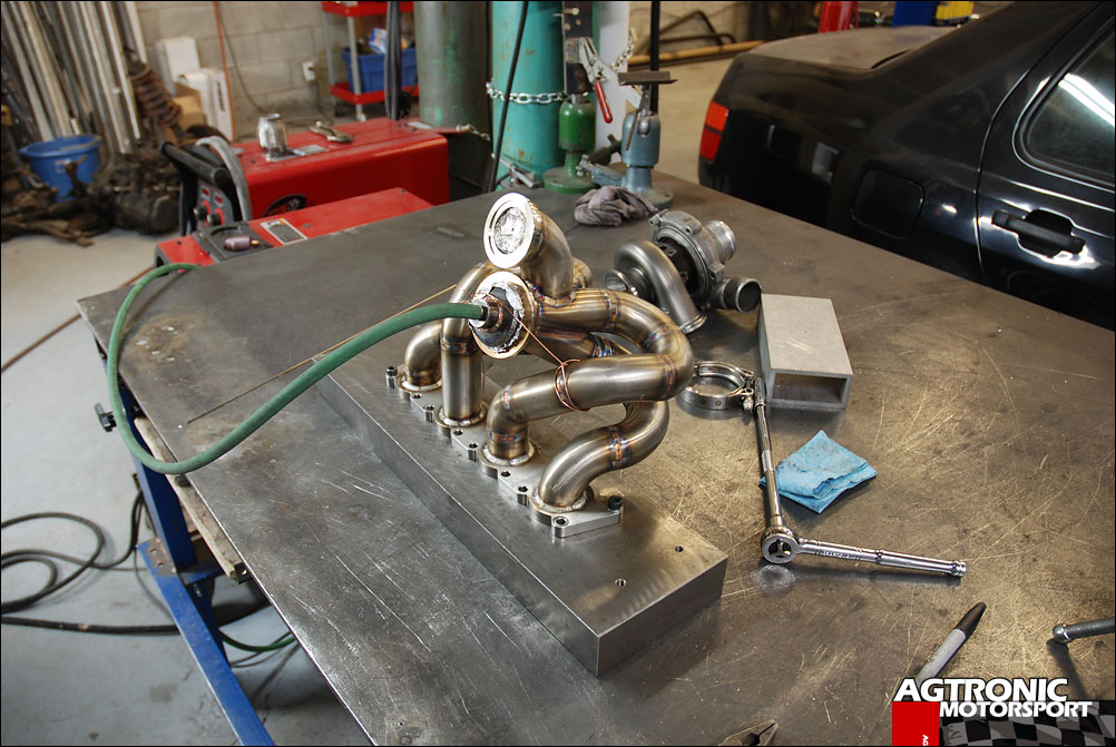

Here are some pics of my setup.
Dual regulator :
Table-mounted valve to shut off gas flow when stopping for tungsten prep, phone call, etc ...
Purging in action:
And this is how it should look inside after you're done welding:
Hope that helps!

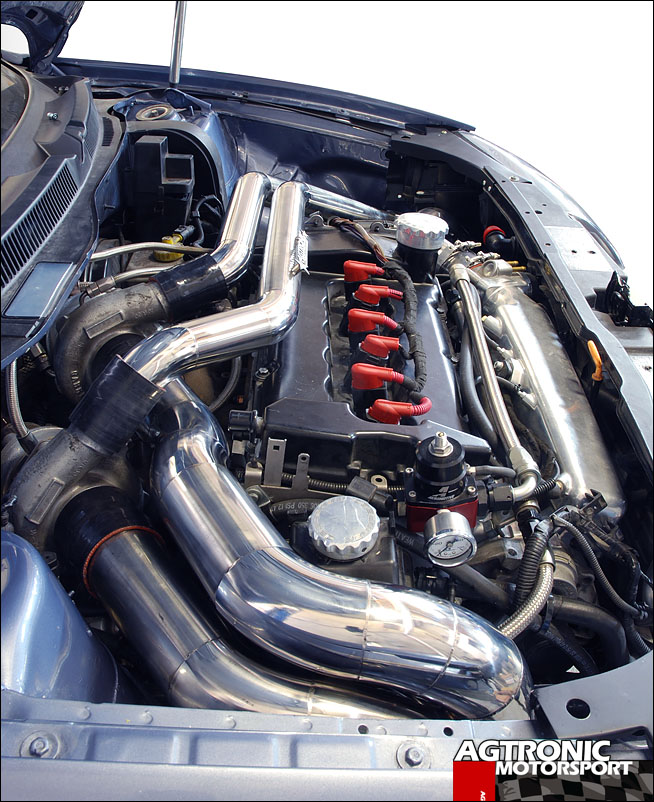

thats some good info! what do you mean by boost pipes? Are you talking about intercooler piping?

^^yes he is

Yep, I was referring to intercooler piping. I normally fusion weld it when using stainless.

I just picked up a 2nd regulator for peanuts to use for my back purge setup. I'm going to use that remote shutoff idea, thanks Agtronic.
