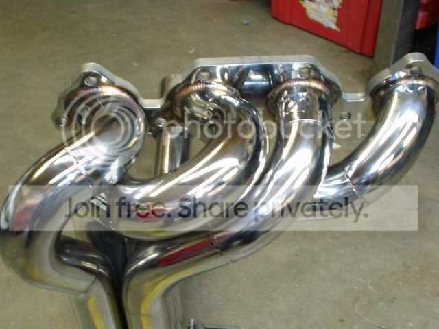

You guys shouldn't be so hard on yourselfs. Build a few sets of headers and you will throw that thing in the trash.I can eyeball a cut dead nuts everytime.And so could everybody else after you do it enough. I have cut so many tubes ,I can just about throw it at the saw and its right on.LOL
The idea is to have the least amount of welds .Not to see how many you can get.
Rule #1 Never weld 2 pieces of straight together. Go straight turn straight turn. When you put two straights together it looks like a goof up.This is a pretty good example.See how there is not any straight to straight welds?
Modified by RMF at 12:23 AM 3/11/2006
Modified by RMF at 3:32 AM 3/11/2006

<TABLE WIDTH="90%" CELLSPACING=0 CELLPADDING=0 ALIGN=CENTER><TR><TD>Quote, originally posted by RMF &raquo;</TD></TR><TR><TD CLASS="quote">You guys shouldn't be so hard on yourselfs. Build a few sets of headers and you will throw that thing in the trash.I can eyeball a cut dead nuts everytime.And so could everybody else after you do it enough. I have cut so many tubes ,I can just about throw it at the saw and its right on.LOL
Modified by RMF at 3:32 AM 3/11/2006</TD></TR></TABLE>
That works great when you have the space, but guess how long it took me to make this. The customer wanted it to bolt to the stock ball-socket type connection y-pipe, have a merge collector and have it equal length while also clearing his supercharger/water-air aftercooler setup. I had fun with that.
This product would is designed for situations like this. Not for a generic longtube setup. I've built a 'few' sets of headers myself and am not full of myself enough to totally disregard a great product that is going to save time and money.
Old Mar 11, 2006 | 06:22 AM

Oh you made that deal ? Sorry about that.Hey maybe some people DO need to use it .I was just saying that me personally ,I wouldn't ,Because it would slow me down.I'm not stuck on myself. Its just that I have made 1000s of headers in my life.
Your headers look good .But they are just different than I would do them.You have 6 and 7 welds per tube.On this header here there is 2 and 3 at the most.
Your doing a good job .I was just sharing a little of my 30 some years making those things.
