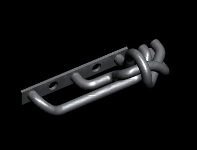

Thanks guys... I have been all over Burns SS website, never thought of simply asking them. But I think I have changed the design so that it does not matter. Originally, I was going to have the three runners tie into a single one then go to the turbo. After playing around, my buddy stumbled on a sweet equal length header design that will allow me to run all 3 runners to the turbo. By the way the turbo will be mounted on the side of the engine.
