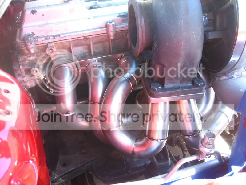

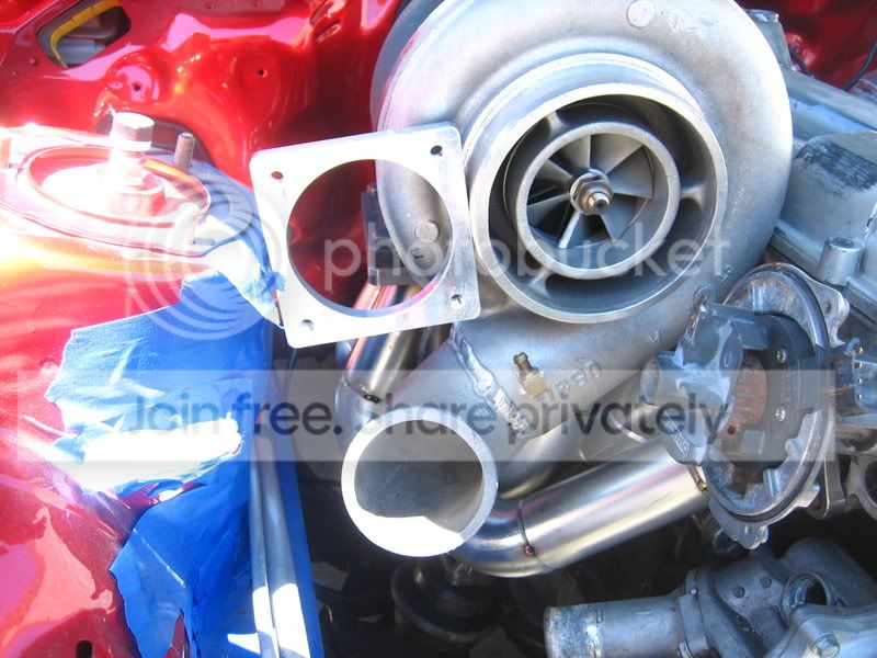

before i made a single scroll t4 manifold for my supra due to time constraints of getting my car back up and running asap for the tuner to fix.
of course the BW 372 is a split divided manifold, now that my head is getting worked on i figured i'd throw on the junk head and make my setup legit !!
just some mock up pics..
flange is holding the manifold and head up cuz its not bolted down hahaha

Default Re: 2JZ-GE split divided BWS372 (project dc2)
wouldnt it be easier to use a t6 divided flange with 6 runners?

Looking good. Where did you pick up the exhaust head flange for it?
Old Jul 4, 2008 | 08:41 AM
project dc2's Avatar
Posts: 45,428
From: 43257 Osgood Rd. Fremont, CA 94539
Default Re: (kings_blend)
<TABLE WIDTH="90%" CELLSPACING=0 CELLPADDING=0 ALIGN=CENTER><TR><TD>Quote, originally posted by kings_blend &raquo;</TD></TR><TR><TD CLASS="quote">Looking good. Where did you pick up the exhaust head flange for it?</TD></TR></TABLE>
picked it up off dave H from Boostwerx
<TABLE WIDTH="90%" CELLSPACING=0 CELLPADDING=0 ALIGN=CENTER><TR><TD>Quote, originally posted by downeyballz &raquo;</TD></TR><TR><TD CLASS="quote">wouldnt it be easier to use a t6 divided flange with 6 runners?</TD></TR></TABLE>
t6 has too big of an exhaust side, its a bitch to spool the t4 setup as is with the 72mm, supras aint " all that" hahaha
<TABLE WIDTH="90%" CELLSPACING=0 CELLPADDING=0 ALIGN=CENTER><TR><TD>Quote, originally posted by JDMCRX &raquo;</TD></TR><TR><TD CLASS="quote">What chassis is that?</TD></TR></TABLE>
JZA80
<TABLE WIDTH="90%" CELLSPACING=0 CELLPADDING=0 ALIGN=CENTER><TR><TD>Quote, originally posted by manifoldmiketyson &raquo;</TD></TR><TR><TD CLASS="quote">looks good. cool to see you went up high. are you planning on an intake?</TD></TR></TABLE>
that stupid distributor pretty much preventing it, i went that high to clear the frame rail and motor mount, altough i could've dropped it down a lil bit, i need a new hood now =T oh wells, i barely have time to work on my own car, i try to shove in time whenever i can, so im not going to complain, i will use it as is. <TABLE WIDTH="90%" CELLSPACING=0 CELLPADDING=0 ALIGN=CENTER><TR><TD>Quote, originally posted by jsw_1986 &raquo;</TD></TR><TR><TD CLASS="quote">Super sexy!!! Can't wait to see finished product... building it for you or a customer?</TD></TR></TABLE>
its for my own car ..

72mm on a supra is not very big at all. probably one of the most common sizes.
i do agree that a t6 would be a little laggy. you should be able to put down 850~950 with that turbo.

to bad u couldnt rotate the turbo flange a little to miss the dizzy... are u gonna be able to still get a filter on that snail? fmic in the future? i want more info on the build! :D
how much clearence do u have between the turbo housing and the valve cover? and do u think that snail is heavy enough to make ur mani sag when it gets heated enough?

<TABLE WIDTH="90%" CELLSPACING=0 CELLPADDING=0 ALIGN=CENTER><TR><TD>Quote, originally posted by SPROCK3T &raquo;</TD></TR><TR><TD CLASS="quote">are u gonna be able to still get a filter on that snail? </TD></TR></TABLE>
and how are the oil return lines run on setups like this? seems super tight

950whp is very high for a 72mm. 850 should be no problem. A 72mm should spool very well w/ a t4 divided hotside for the street.
You might be able to kinda fit some sorta intake with the 4 runner cap.

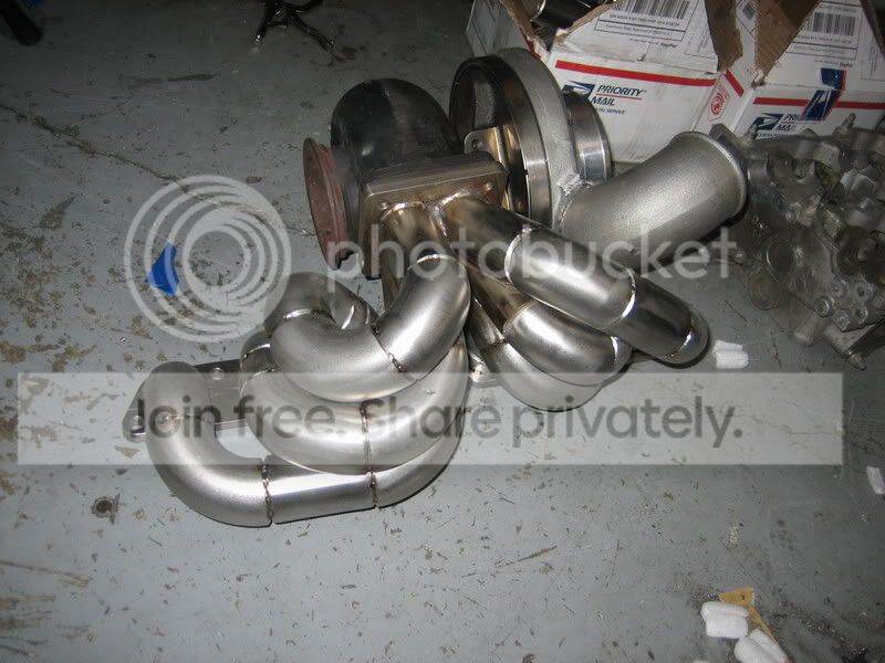

Do you have some sort of machine that puts that wicked smooth bevel on the ends of all of your pipes?
I've been working on a set of Fender-Well exit headers for my dad's hot rod and my biggest complaint is that when the edges of the pipes aren't smooth/dont line up perfect it makes the weld a million times harder. those ones look wayyy easier to weld
Also, are you taking the pipes off at the flange, welding up the complete individual tube then welding them back up to the flanges when they're all finished?
Thanks and also nice project

i use a 20" sanding wheel to get the bevels on
i tacked all the tubes last night in 6 seperate areas so they dont shift when i weld, hopefully ill do some finish welding today. at least to the runners
