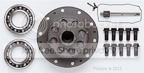

so i put a spoon diff in my trans and little did i know i need to use the vss gear that is given but since i didnt buy it new i dont have it.. does anyone know where i can buy one... i have checked around and could not find anything for sale... the spoon website doesnt show one for sale unless i just completely missed it.. or is there one from a different diff i could use...

What diff is the car for?????
You can't buy the speedo drive gear from Honda, LIKELY the Mugen speedo ring gear may work.
$185 from King
(OUCH!)
http://www.kingmotorsports.com...at=34

Its in a gsr trans.... but I don't need the ring gear... I need the gear for the speed sensor... apparently the one for the spoon diff is slimmer than the stock one... I will post a pic a lil later

picture of your diff......
That looks like a Kaaz/Cusco, the speedo drive is about $75, I know I ordered two a few months ago.

PICTURES OF YOUR DIFF first, esp. the speedo gear area.

https://honda-tech.com/zerothread/2417570

coo i think i found all the info i need... thanks much
