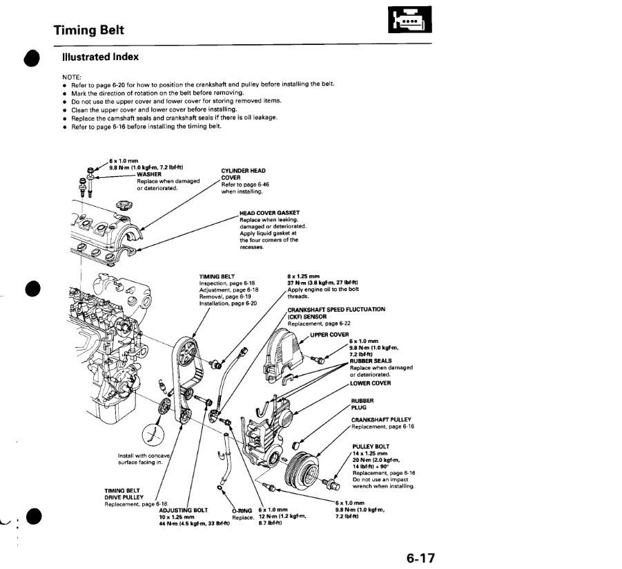

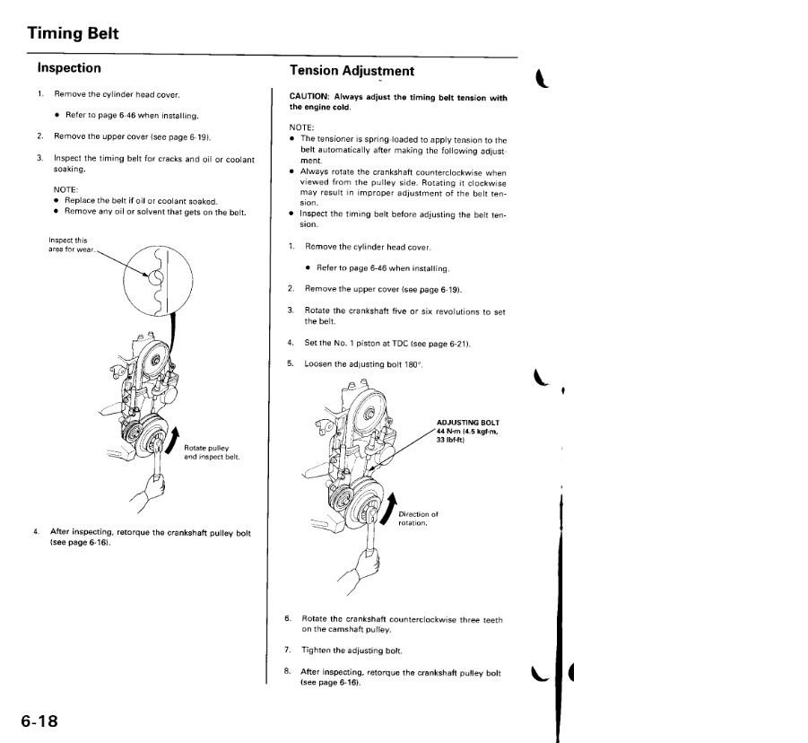

The three teeth is for removing the slack from the drive side of the belt. By drive side I'm talking about the left side (what you call the long side) when you are standing in front of the engine looking down at the timing belt. Tightening the adjustment bolt should not change the tension on the belt. Did you follow the steps like in the images below? Yes the images are for a 96 -2000 but the steps should be the same. It's just standard timing belt tightening.

When I tighten a timing belt I take the slack out of the long side by turning the engine over by hand. You don't need to go exactly three teeth. All you're doing is making sure that you turn the engine enough that the belt starts turn the cam shaft. The camshaft resisting turning is what sets the tension on the belt. Once you have that tension set (on the long side) you just loosen the adjustment bolt and let the spring pull the slack out of the belt. On a new spring that should be enough. On a used spring I always use one finger to put a tiny bit more pressure on the adjustment pulley while I tighten the bolt. By tiny bit of pressure I mean take your pointer finger and put the side of the second knuckle (the joint that's closest to the end of your thumb) against the pulley and push sideways. most likely you won't even see the tensioner move. You just want to make sure that a bit of grit isn't possibly holding the pulley from sliding.
