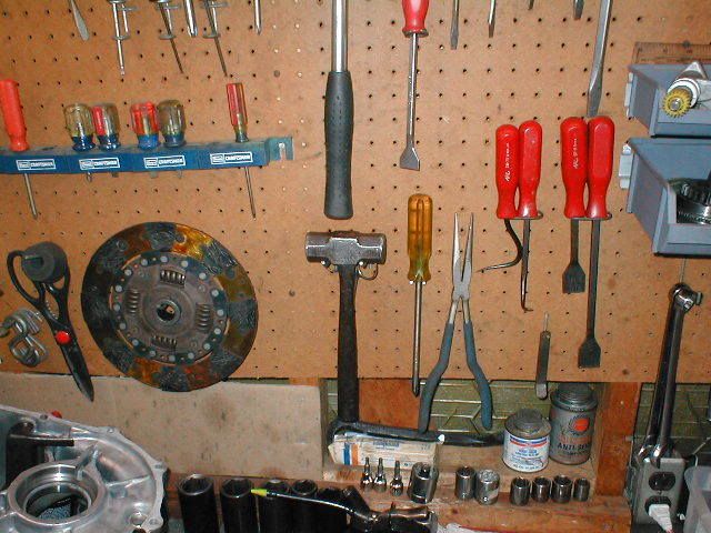

I have a old clutch on the wall for bench shifting as well as a shift linkage handle.
