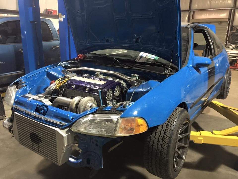

So I'm building the first Honda I've ever bought, and I'm making sure everything is done right the first time.
It's a eg hatch gsr, with a garret Gt35r .70 ar. Looking to be around 500-550 range. I'm currently looking for a transmission I belive I found one. But the only question is that some people tell me the gears are to small due to the final drive. These are the specs, let me know what you think,
gsr transmission
ls 4th and 5th
gear X 4.7 final drive
Mfactory LSD
fresh rebuild with synchrotech synchros and oem bearings.
