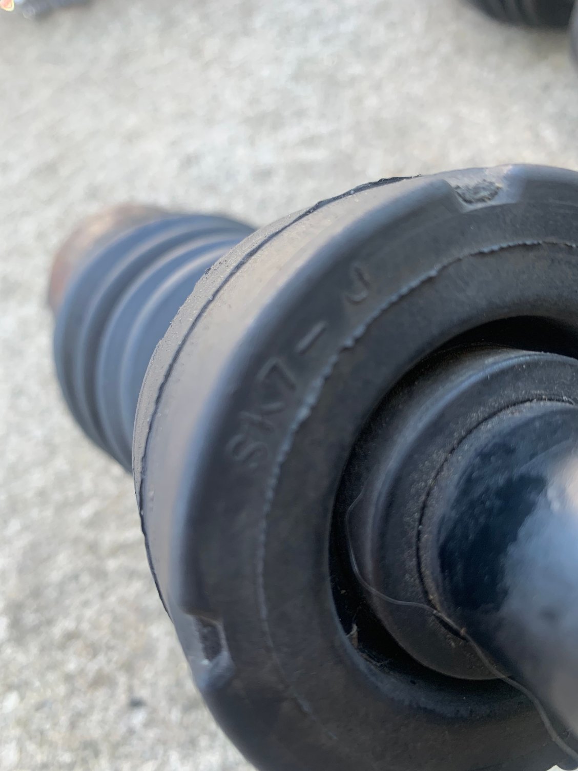

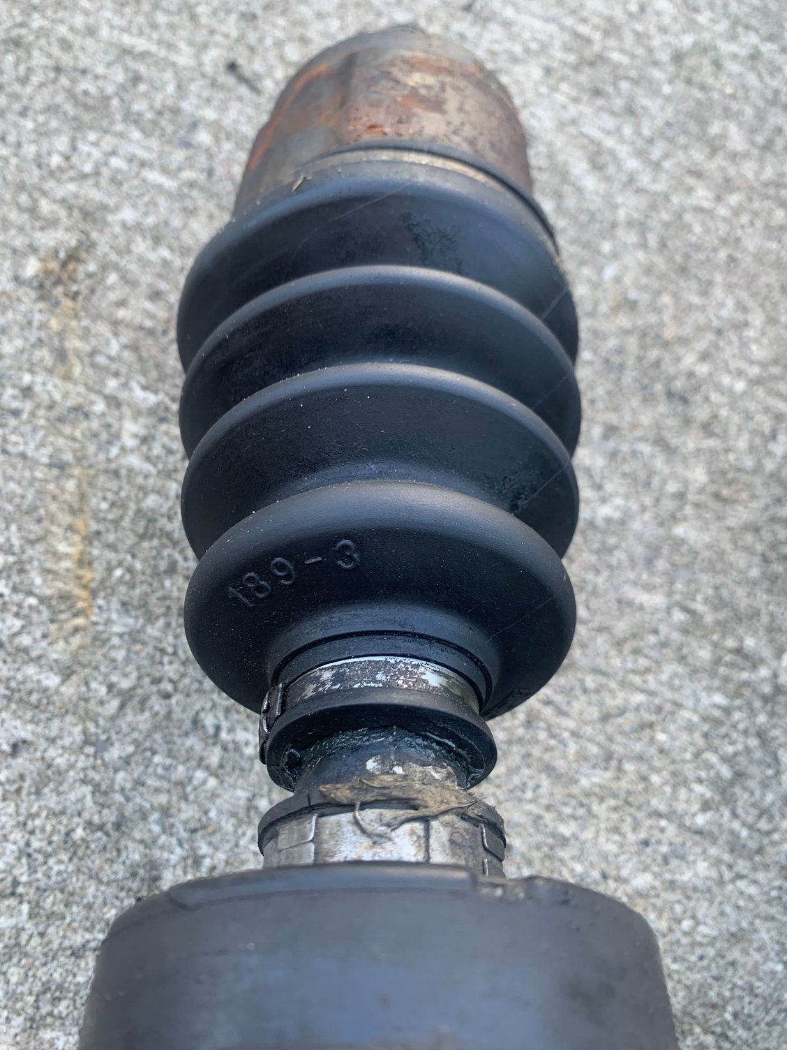

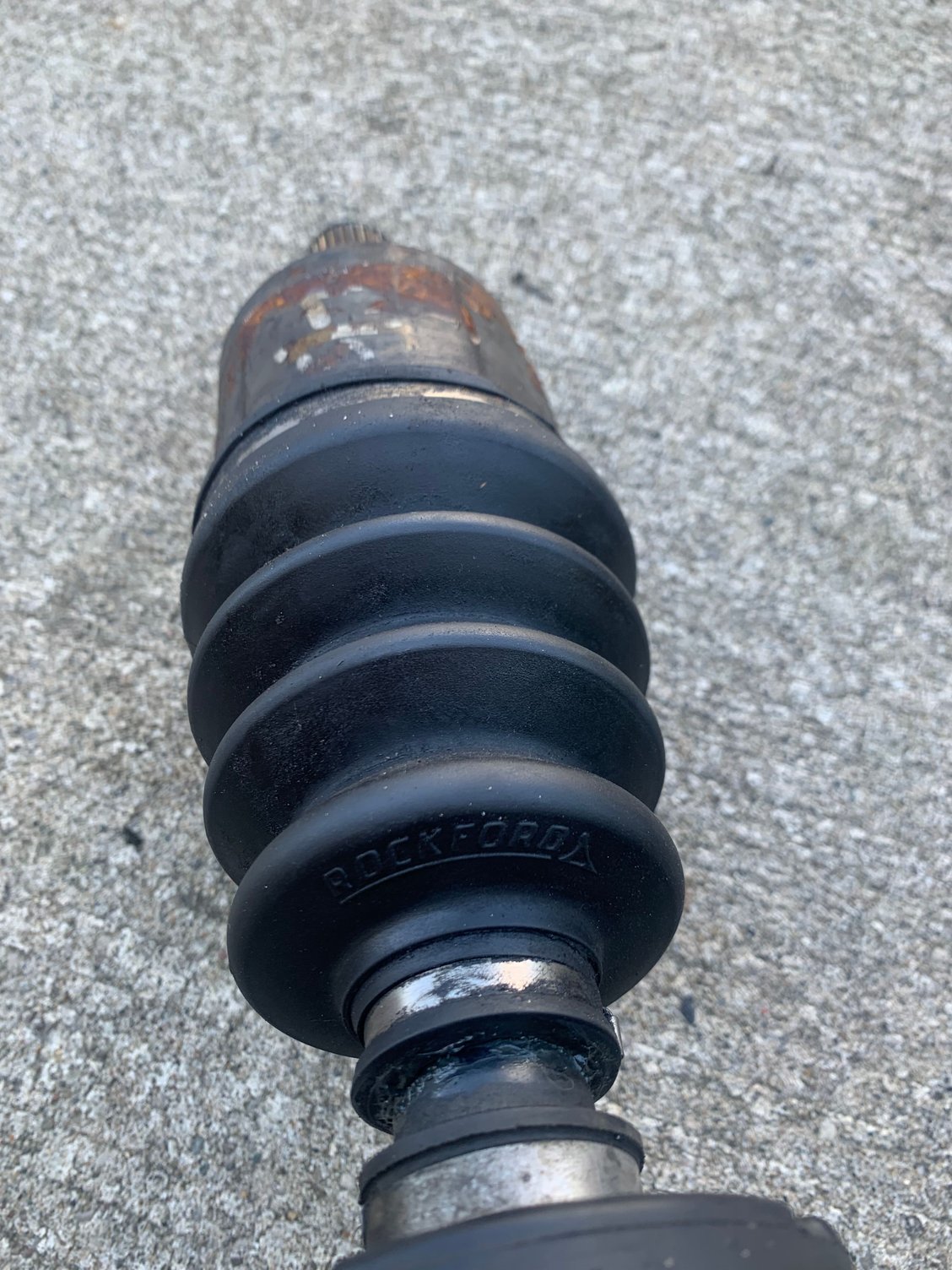

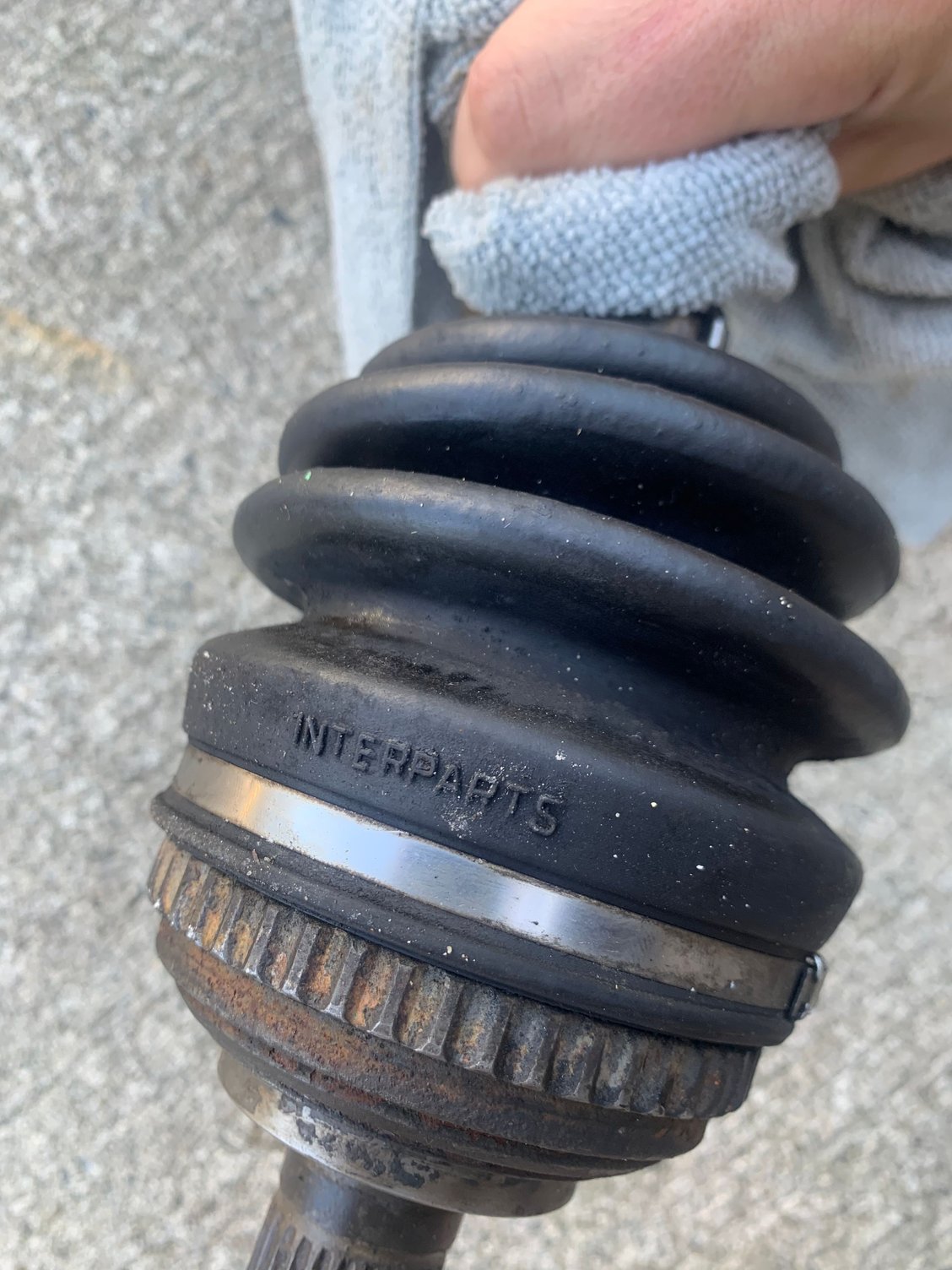

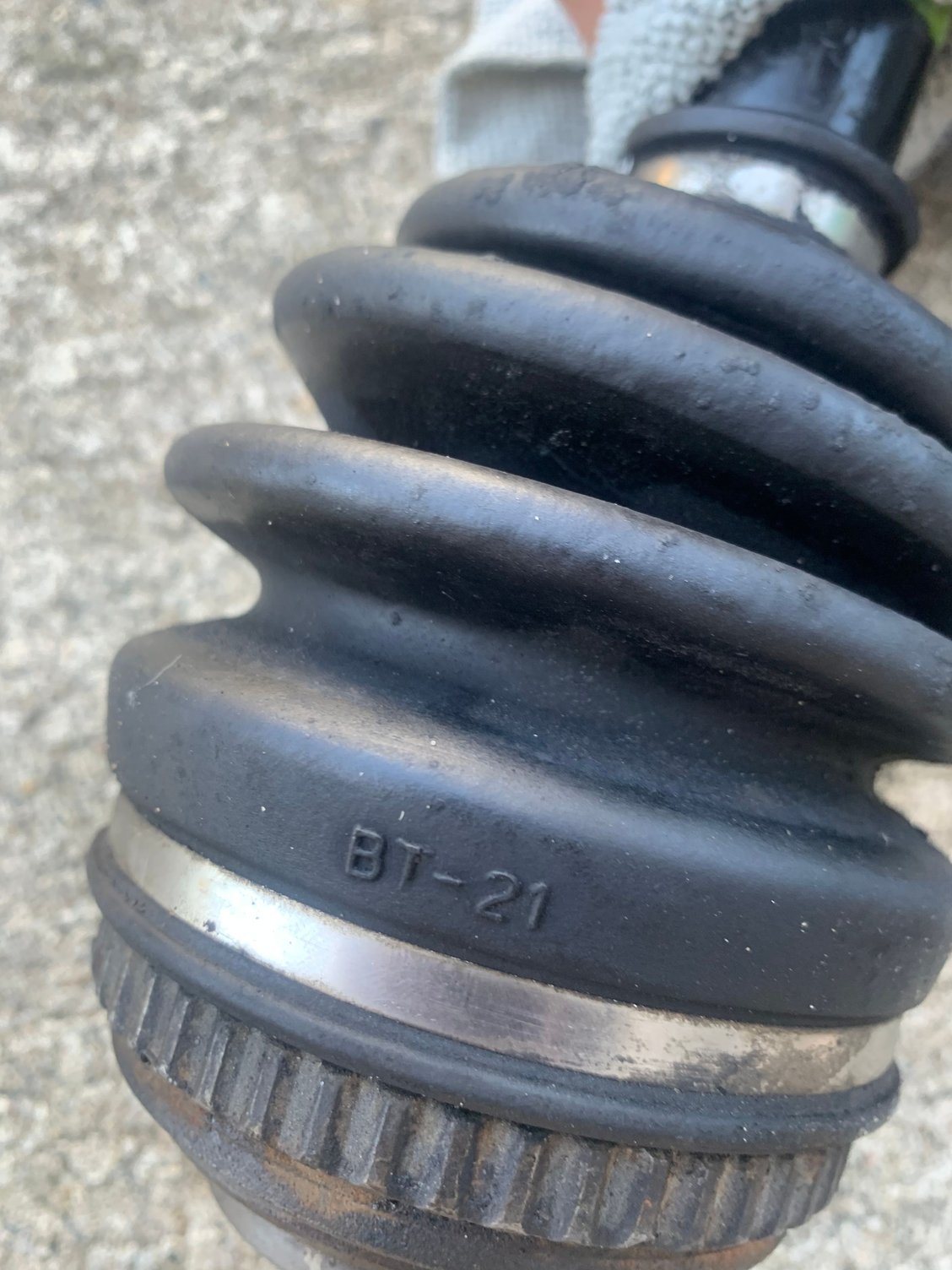

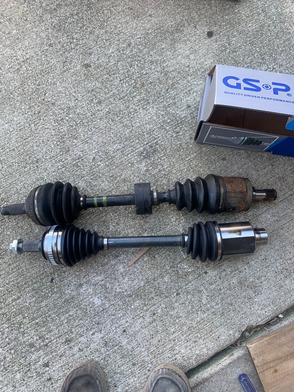

Now, I ordered the drivers side axle too (95 Integra) but it is different. It had a female end rather than the male. There are a few numbers on the boots of the old shaft… looked them up and couldn’t find much. Maybe somebody can help me here.
So does anybody know what axle this is? And what one I can buy that will work? Thanks.
Old on top, new on bottom (drivers side)

there are no off the shelf axles that will work for h22 swaps
the axle you pulled out that has male ends on both sides is from a 90-93 integra
the reason you have a shudder when making turns is the axle is too long and it is binding up
