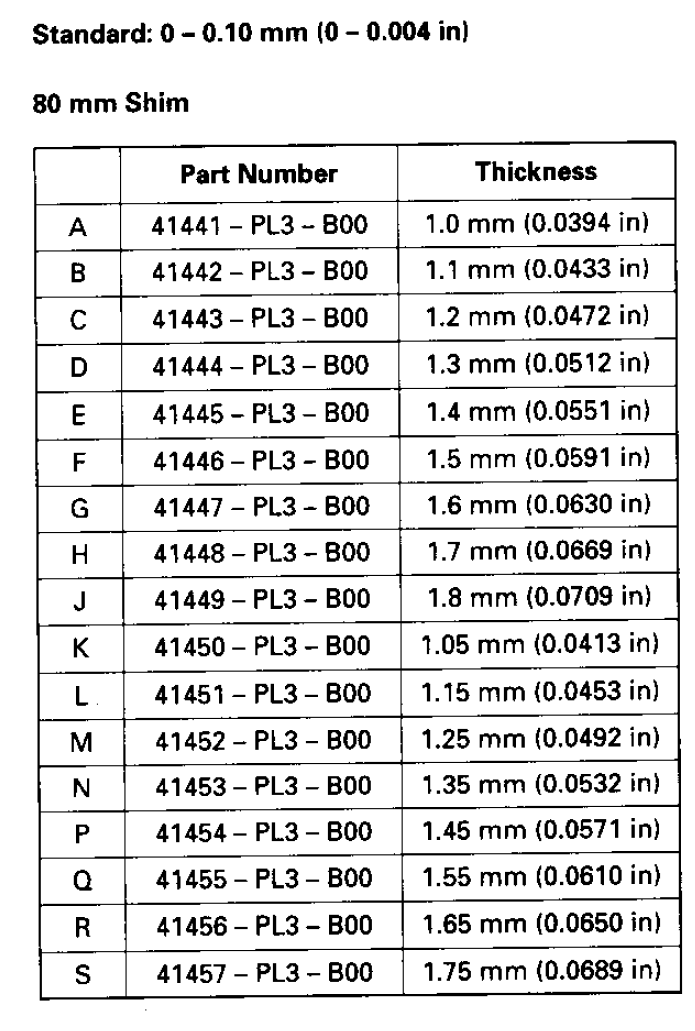

So, after waiting a week and a half to get the rest of my parts to put the trans back together, I find a message on the dealer's website ;letting me know that my diff shim was on backorder with no restock date. Sucks, I wish they would have sent me an email directly and I would have gone one size up or down and been fine or found another one somewhere in the last week and a half. Possibly there goes getting the trans back together this weekend. Had to blow off some steam on that one but anyways...
I sent an email to Andy at Synchrotech since their close-ish to me, but I'll post here too. I need a 1.6mm thick shim to get to nominal clearance (.05mm) and I'm at 0.2 with the original 1.45mm. I could go one up or down and still be in tolerance. I'm going to go measure again just for a sanity check too, but I'd love to hear some experience from the pros on whether I should ship the thing or sit on my hands for another week and try to find the correct shim.

Yeah it’s the 1.6. I fat fingered the decimal. 80mm diff thrust shim for an s80 gsr trans. I’m going to put it all together one more time tomorrow and make 100% sure I need it.

Clearance is definitely right at .2mm with the 1.45mm shim. I can get a .008" feeler in there snugly and a .009" is no-go. A 1.6mm (41447-PL3-B00) would get me to the middle of the band @.05mm, so I could do a 1.55mm (41455-PL3-B00) or 1.65mm (41456-PL3-B00) and still be in spec. Not sure if a little tight or a little loose is better. I should have posted this earlier:

If it's not a race car you're fine anywhere within the spec.

Thanks. I'm a touch loose. I guess I'll see what I can come up with.

So, we'll see how this goes. I talked to a handful of guys local and otherwise and did some internet research. The general consensus is that I will be fine with the base shim. Some trans builders actually seem to prefer opening up the play a little when installing an aftermarket LSD. I don't know if this is due to an expectation of looser tolerances compared to original diffs or what, but I found guys who prefer them to run looser than what I have. The general recommendation is that, as long as there is no side to side or up/down play when fully assembled that I will be fine.
