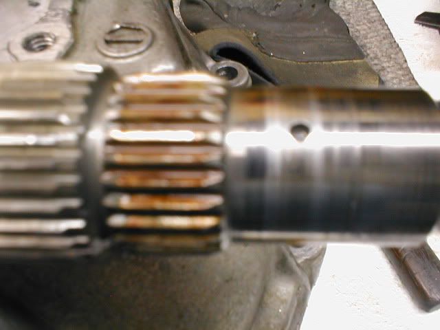

I almost always lean on the lazy side and almost ignored tbone's advice...
After stripping down the countershaft it was clear why hes the guy to listen to..
After blowing through the shaft and thinking it was fine... found 2 of the oil passages clogged to the point i had to use a pick to clean them out. A good bit more grit and grime came out.
On the mainshaft the needle bearings were packed with sludgy grit grime. This is all after thoughoughly cleaning the shafts while together.
Taking apart the shafts was easier than splitting the case. I should have ordered the little dampers in advance... cuz now I'm going to have to wait another week to get it back together.

In the top picture you can see the clogged oil orifice in the counter shaft too... that was after having blown through it before dis-assembling it and feeling that it seemed clear/unobstructed when I blew through it.
I can't even begin to explain how happy I am I spent the extra time and effort taking it all apart.
Did you have any sludgy/metal on your magnet? If yes even a little... clean the shafts. Well worth it.

Here's what came out of my countershaft with a little brake parts cleaner through the oil orifices.
Strip 'em down and clean 'em up!
