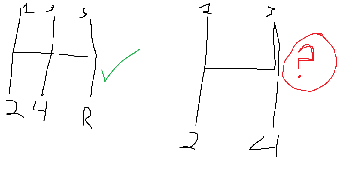

From what I noticed when rebuilding the shift linkeage no, no looseness in the shifter itself, All my other gears 1-4 go in nicely but I cant feel the inbetween part that tells me I'm in the position where 5th or R would be
1 3 5 1 3
As a visual demonstration Normally a Shifter should be like this l_l_l what I feel when Playing with the shifter is only this l_l and then the section where 5th and R is feels like a physical wall is blocking me from entering the section where those 2 gears would be
l l l l l
2 4 R 2 4
Hopefully this makes a bit more sense !

sorry that visual didn't format how I thought it would so I drew something up real quick on paint this is whats happening pretty much

If you can’t shift into 5th or reverse with the engine off, you probably have a shift fork problem. 5th and reverse share the same shift fork. Yours is probably bent.
Last ditch effort would be to take the shift linkage off and use a screwdriver to try and run through the gears with the screwdriver. If it still doesn’t work, your shift fork is probably bent or broken.
