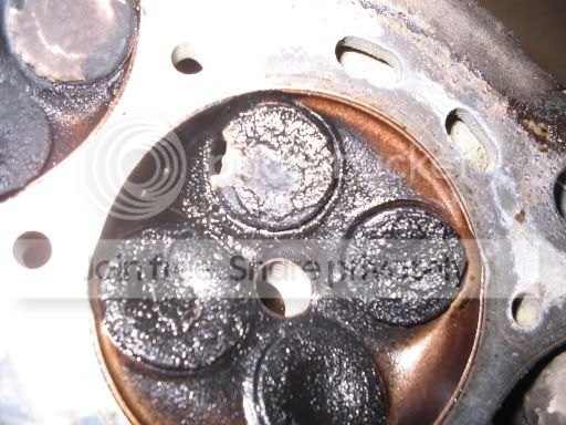

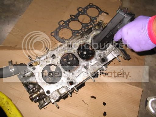

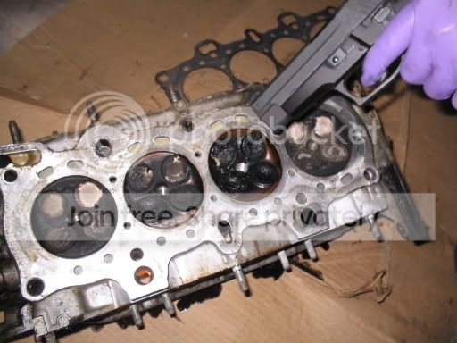

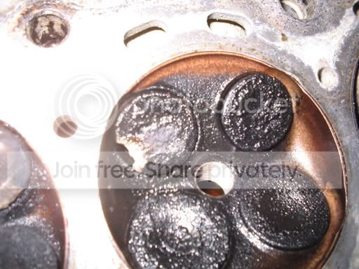

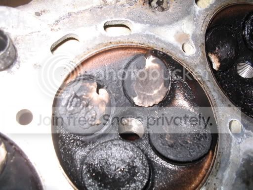

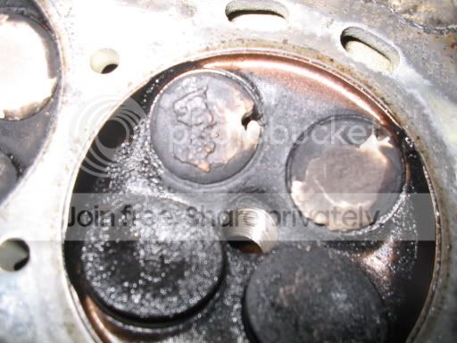

Leak down tester will be here Tuesday at the earliest. Here were pics from the old head. If compression is good, could it really be the head gasket ?
Here is the old head, it was not reused.
