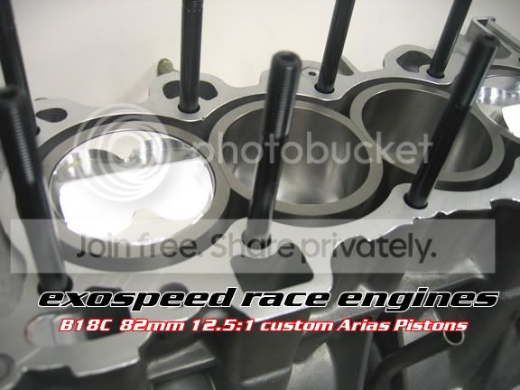

you should search. but ill tell u anyway. sleeving is the process of boring the old sleeves (cylinder walls) and replacing with new thicker stronger sleeves. a sleeve is exactly what it says. its a sleeve of metal used for something to ride on. need more?

Its replacing the original cylinder sleeves with usually a stronger Iron Ductile sleeve.
The original sleeves are limited on how much you can bore so most people sleeve the block to make it stronger and/or go bigger bore to increase displacement.
There are different styles of sleeves, but the next 2 pictures are DARTON MID sleeves in B-series engines.
This setup is an open deck style Darton sleeves, which doesnt have the flanges on the top like the Darton MIDs do.
Here is a comparison of a D16 UNsleeved block and the bottom pic is of the same type of block but with the open deck Darton sleeves.
