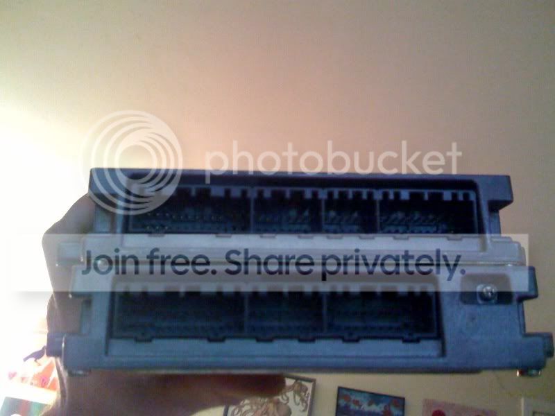

I recently got back into the Honda game and I got this ECU with a swapped EF I bought:
It has obd-1 plugs and plugs into my car just fine. The car will start, but only idles for a little bit before turning off. Im not too concerned about it not working because I have a couple of regular p72 ecus that work just fine.
So Honda-Tech, where did this ECU come from, and what can I do with it?

you sure its obd-1? Looks obd2 to me.
Old Sep 26, 2008 | 04:32 PM
SOHC my DOHC's Avatar
Posts: 65
From: Littleton, CO, US of A
The plugs are obd-1, with the addition of another plug. The inside looks like obd-2 though.

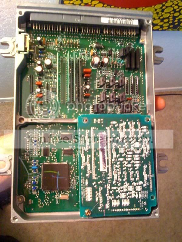

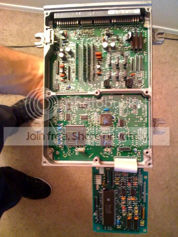

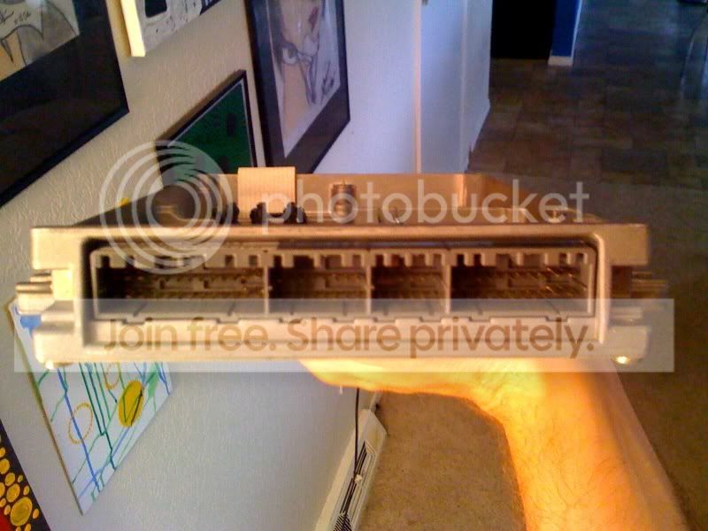

Here is a picture comparing this ecu to a normal obd-1:

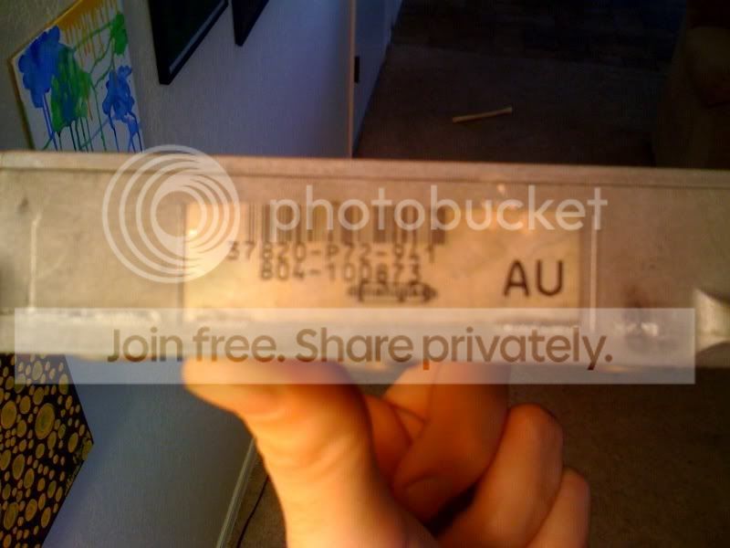

Thats the guy who I bought the car from.
He never received a straight answer on it. Everyone thought it was just an obd-2 ecu. An obd-2 ecu wont plug into an obd-1 harness.
I also think its weird that that is the only link that comes up when you search the ecu number.
Old Sep 26, 2008 | 04:40 PM
fourthgenhatchB17's Avatar
Posts: 5,365
From: 60ft garage, CA, USA
Default Re: What car did this ECU come from? (SOHC my DOHC)
Auto p72 from what ive gathered.
http://www.hondata.com/forum/v...ec530
Old Sep 26, 2008 | 04:43 PM
Posts: 65
Default Re: What car did this ECU come from? (fourthgenhatchB17)
<TABLE WIDTH="90%" CELLSPACING=0 CELLPADDING=0 ALIGN=CENTER><TR><TD>Quote, originally posted by fourthgenhatchB17 &raquo;</TD></TR><TR><TD CLASS="quote">Auto p72 from what ive gathered.
http://www.hondata.com/forum/v...ec530</TD></TR></TABLE>
There we go.
So this thing needs an auto tranny to even run a car?
Old Sep 26, 2008 | 04:45 PM
Posts: 5,365
Cant help ya on that one, lol. Maybe an ecu guru will chime in.
Old Sep 26, 2008 | 07:59 PM
mtber's Avatar
Posts: 48,168
From: Tampa, FL
That would be an automatic obd1 p72 ecu for an automatic integra gsr.
I have not tried running one in a manual vehicle, however I doubt it would work very well :-)
