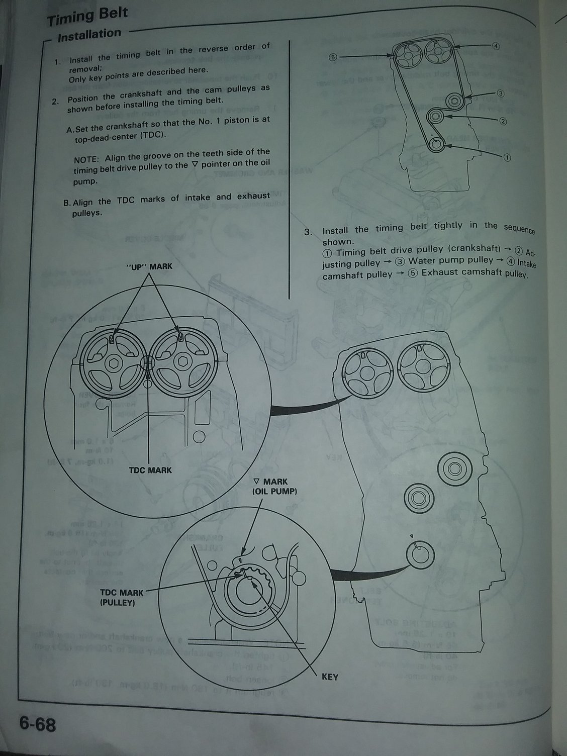

Whuuuut? Y'all are funny, one says "it's on the TB side of the motor" and then the next guy is like "UUUMMMM it's on the timing belt side". Like, yeah TB == timing belt. Anyway its also worth mentioning that most (if not all) b-series also have an index mark on the crank pulley and block for #1 TDC and there are additional index marks on the cam gears which should also be right next to each other when at TDC on the compression stroke. Also, with regard to the varying bolt sizes on the water pump, 2 are longer and they go in the holes with the metal sleeves that double as aligning dowels for the water pump housing and the block. (pic is from my db2 official repair manual)
