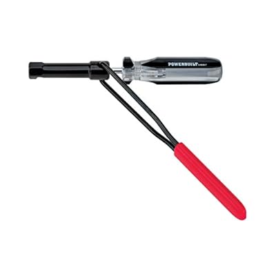

as for the "special tool" I see it turns what looks like a screw (on top of valve) in which a flathead screwdriver goes into, and a 10mm wrench. Now when I losen/tighten the valve up, do I losen the screw also, or leave it alone and just losen/tighten the bolt?

The screw slot adjusts the clearance. The 10mm jam nut locks it. Amazon and others sell a tool to make this process easier.
http://www.amazon.com/Alltrade...&s=hi

You loosen the lock nut and adjust the screw to get the proper clearance with a feeler gauge. Then you hold the screw driver steady while you tighten the lock nut, taken care to not move the screw or over-tighten the lock nut. You can buy the tool or just use a box end wrench and flat head screwdriver.
You won't get it right the first time, mainly because you have to learn what the proper drag feels like. If you can get the next size up feeler gauge in you're too loose and if you can't get the next size down feeler gauge in you're too tight. It'll take you a few times. Just remember to take your time until you get used to the proceedure.
