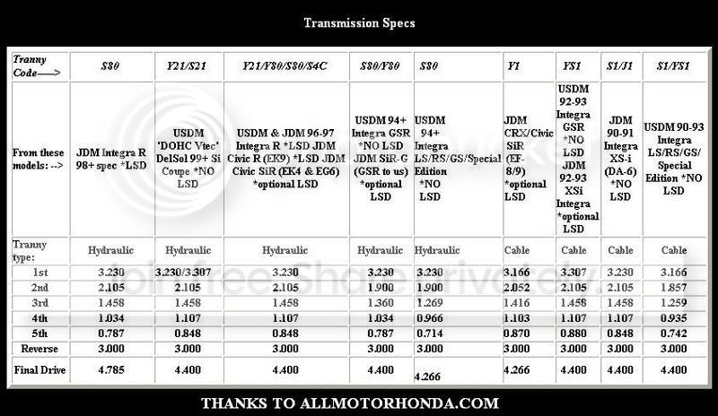

i found this on the internet and if you notice the xsi integras and the ls's both share the s1 code. what i wanted to know is there a part of the code that distinguishes the xsi trannys from the ls trannys?
