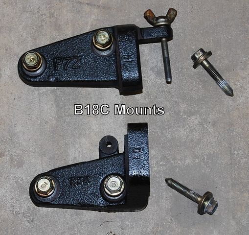

Can someone please let me know what the torque settings are for the four bolts that fix the power steering brackets to the engine? Thanks in advance

The factory spec is 33 ft/lbs.

Pro tip: Make sure you use some anti-seize on all of those bolts anywhere a bracket bolts to your block. It will save you a headache sooner or later.
Unfortunately, doing so will completely ruin the desired torque specification.
Personally,Id forgo the torque specs in this case and use a dab of anti-sieze and just tighten the bolts "good" enough.

Well, suggesting the use of anti-seize becomes a slippery slope. It is technically not recommended, because it will alter the friction characteristics of the bolt and thread interaction and cause it to be over tightened.
However I understand the reasoning behind the suggestion and agree with it. Once you go there,though, you can no longer give accurate technical directions. I intentionally put good enough in parenthesis assuming that those that are reading this will comprehend the ambiguity of the term, and use their best judgement.
Since most on this site are fairly seasoned DIYers, I feel like they would know what "good enough" is for them.

I would think even with the friction coefficient being thrown out the window from the anti-sieze, the old school 1/4 turn method should still be extremely effective as it's not based on torque measurements and never was. As well as be a specific, consistent method.
