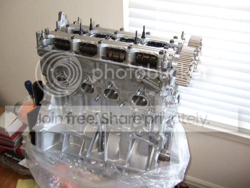

I used a billet Summit ring grinder, an ARP tapered 84mm ring compressor, a Summit ring expander, a Summit (I think) rod bolt stretch gauge, green plastigage, clevite bearing guard, a $30 harbor freight engine stand, a tiny oil can, and some latex gloves. And you'll need a hammer with a rubber striking end to get the rod caps off.
